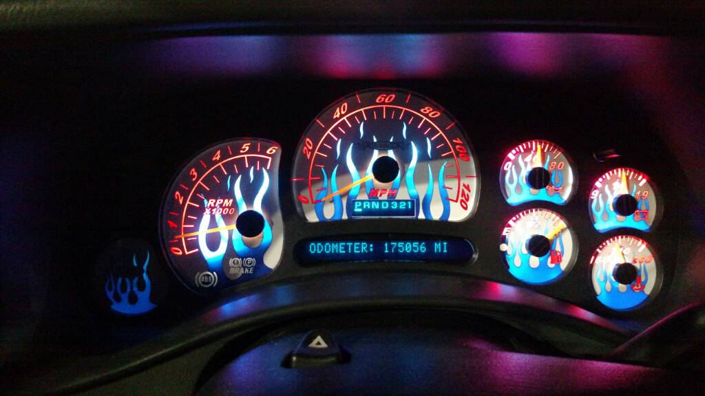

Well, I went all the way. Resoldered the PRND321 resistors, replaced all the steppers, and changed the lighting to LED. I haven't had the shift indicator work for atleast 5+ years.
Thanks for all the help guys, it's a nice feeling spending only $20, and getting it back to new.
