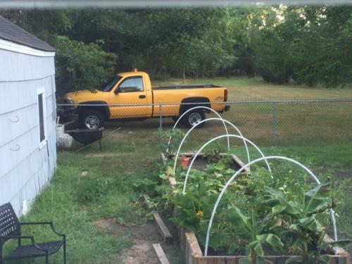

so alittle background info to start, I bought for $3,000 a ugly yellow Silverado 2500HD 4wd regular cab long bed with 6.0 with 4.10 gears no posi, oh with 125,000 miles. The truck was once a "public works" truck, then the second owner used it as a plow truck for a few years. The truck had one issue, besides the color, the floor pan rusted out from the inside out and some one just placed a sheet of metal under the vinyl floor. so a very very long story short, between a other parts truck I have and a new floor pan, I made the floor as best as I can do. I'm 22 and working in the dirt, nothing but dirt or grass on my property, and my job only allows us to work on our own vehicles only Fridays for about 2 hrs max.

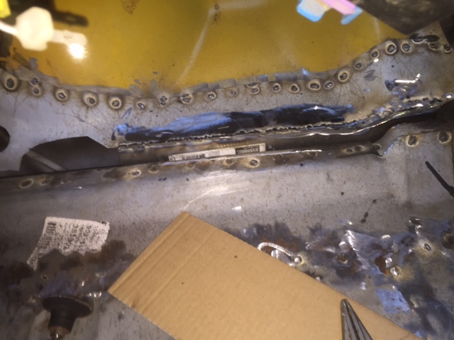

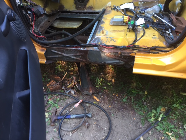

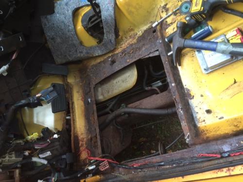

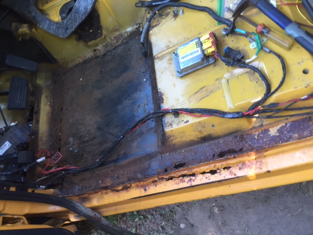

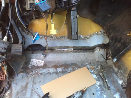

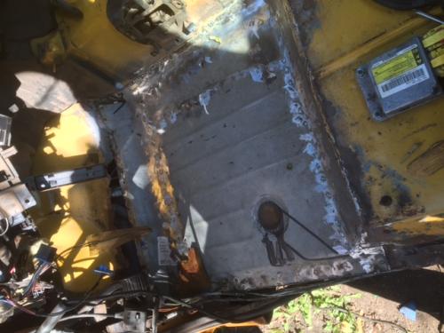

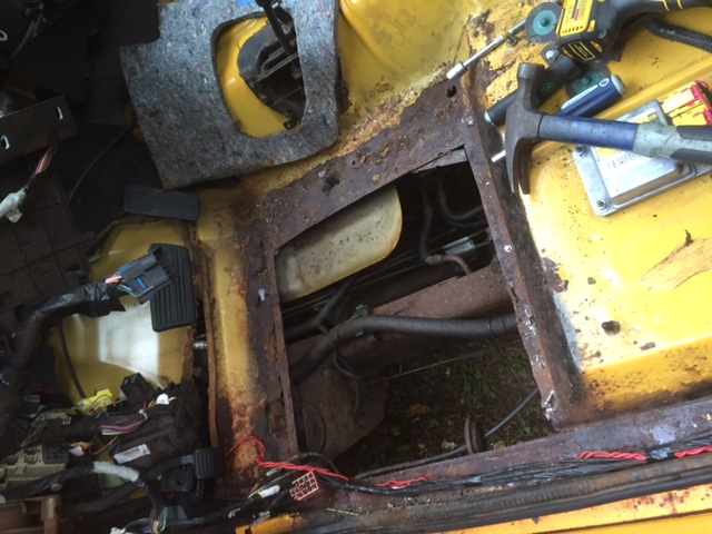

ok so i have pictures of the driver floor pan, before and during some work of the floor pan is rusted out where the floor pan and firewall meet. on the passenger side i had the same rust issue but not as bad, and my parts truck rusted out in the same spot.​ If anyone cares I would check your truck under the pedals.

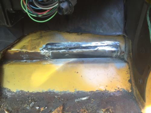

these are the last pictures I have of the floor pan sorry I'm not the best at working and taking pictures are I go along. I still need to repair the rocker but after having a solid floor in the truck again, I painted 2 coats of por-15 over the floor and firewall. I also sprayed this anti rust wax spray I have from work over all of that and in tons on the body holes and openings in and out

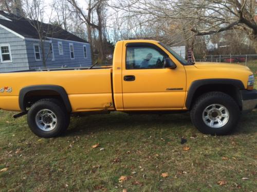

to make the truck not look as much as a work truck, i put h2 rims on with 315/70r17
