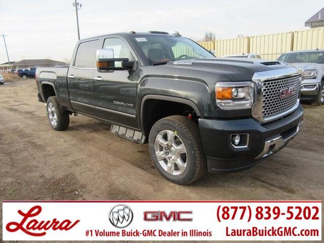

So...good news boys and girls...got a good look at the diagrams for the new tank, and what is under the massive shielding.
The shield is a two parter. The tapered big outer one you see from the side of the truck, and then there is a lower one that attaches under the bottom of the tank. All of the shielding is there, and for a VERY good reason...
The DEF pump module, controller and feed line to the injector is now installed on the BOTTOM of the DEF tank. The LML trucks were designed like a traditional fuel tank, where debris can get trapped on top of the tank. Now, it is more or less an upside down tank. I would highly suggest to anyone thinking about removing the shield, NOT TO DO SO.
i wish they would of just made it wider or longer to completely negate it from hanging under the truck like a skrodom. I get it, its limited space to work with, but it could of been designed better, you can put all the skid plates you want on it, but one approach angle or a rogue stump is going to tear that thing right off.
