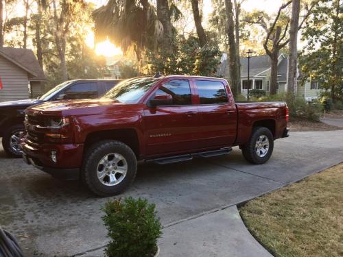

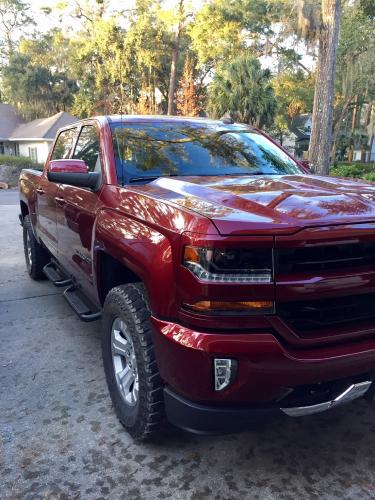

Along the same lines as my exhaust post... I don't post much online in forums but I research them to death for help and this forum has been invaluable, so just for reference to give back - my truck with Bilstein 5100's on the top perch and 295/70R18 Cooper ST Maxx tires. Granted... they're used (transferred from my last truck which was a 2013 F150 where they fit easily) but they only rubbed the fender liner slightly... and I mean slightly. I simply drilled a hole in the fender liner and pulled it back with a zip tie. No sweat.
For what it's worth, I'm all about a rugged terrain tire (ST Maxx, Open Country R/T, etc) for me personally and my work which has me offroad every day and this is my third set of ST Maxx tires. They are awesome, best of both worlds between offroad traction on a rainy day and on-road noise, until the last 10,000 miles of tread and then they howl at the end of their life span. Thinking KO2 next... 34/12.5 most likely....
Actual measured size for 295/70R18 ST Maxx tires is 34.25" x 12" (section width)
Actual measured size for 34/12.5R18 KO2 tires is 33.5" x 12.5" (section width)
Actual measured size for 305/65R18 KO2 tires is 33.5" x 12.2" (section width)
Looks great! If I can figure out how to put 35/12.50R18 KO2 under my 2" level on stocks I'll be happy. But those 295/70R18 look great so I may have to reconsider.
You are the man! i have been scouring the forums for a few months now when ive had time looking for the biggest tire on my stock 18 inch wheels. my trucks leveled a little over 2 inches so im pumped now i can use something bigger than a 33. 295/70 34.5/12 sounds perfect

Great looking setup!

Anyway, hope this helps. Truck drives great and the front sits just a bit lower than the back on the top perch with 5100's. Don't go bigger than 295/70R18 or 34.25" and you should be good. Might have to zip tie the fender liner. 305/65R18 should measure around 33.5" x 12.2" and be no sweat... BFG makes the KO2 in 34" x 12.5" which measure to 33.5" x 12.5" so it's just a hair wider than the 305/65R18. That's my next tire.

Side view
Im about to pull the trigger on a set of 295/70/18 trail grapplers. i see they fit ur truck beautiful but i have mudflaps. wonder if you had any pics of it close to the fender with the wheel cut?

So on 18" stockers, you get no rub at full lock? Everything I've been reading over the past couple of years says this will rub the inside sidewall on the UCA and the swaybar.
