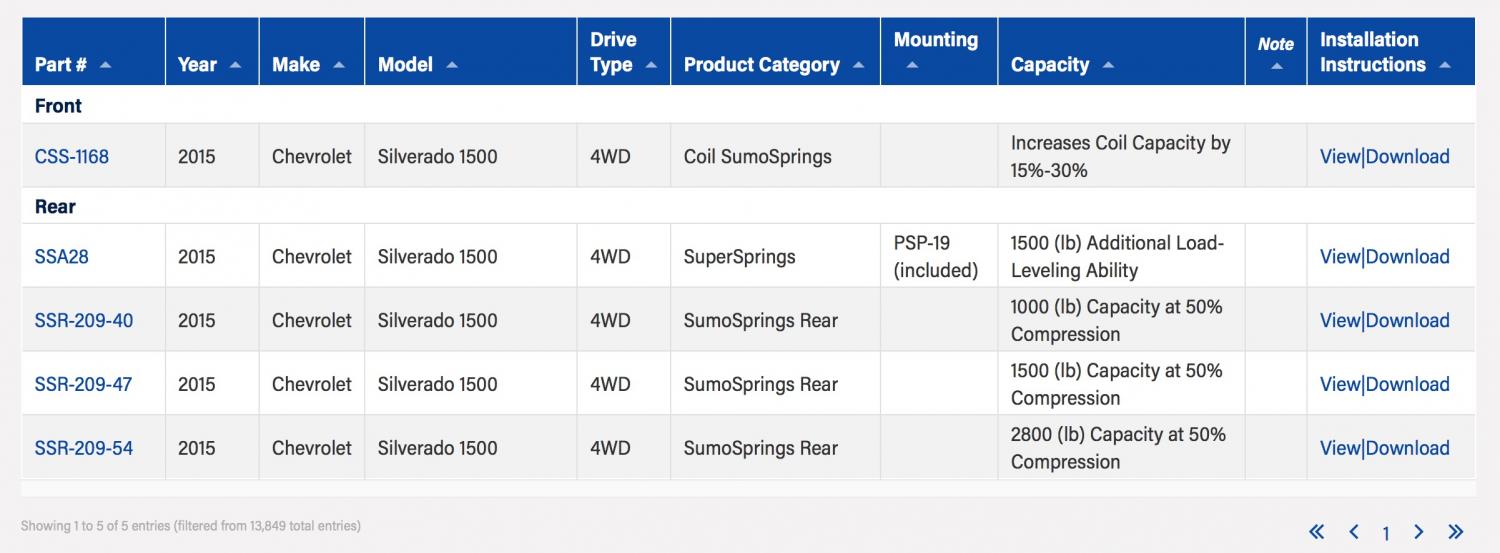

Sumosprings only add 1000 lb capacity, Jon? Really? Not in anything I have read about them. Of course, they do come in differing varieties and models for differing applications. Just looked up the Sumo's for my particular pickup. There are 1500#, 2500#, and 4600# versions available. One can choose what works best for their particular application.
And the Sumo's for mine ride directly on the axle. They are starting to compress and resist right out of the gate. No gap for the spring to drop before contact and compression like is typical of Timbrens. A gradual increase in resistance as opposed to "all of a sudden you are there" like with the Timbrens. Sumo's actually fit in the middle ground between Timbrens and Air bags. They have similar properties of each and avoid some of the issues of each. They don't try to be the same thing as either. They are not a hard rubber that is being flexed alone like a Timbren. They are micro cellular polyurethane foam that has millions of air pockets throughout that offer a similar to air bag performance but require no air input from the driver. Like I stated, kind of a middle ground between the two other options. A "install and forget" feature like Timbren, but air type of suspension like an air bag via the micro cellular foam approach. With the added feature that if they are punctured in any way, it does not affect them. Supersprings bored a 1.5" hole completely thru a Sumospring to prove the point.

Looking at the SumoSprings, for the 1500 series, they only add 1000 lbs. But I'm wondering if that matters? I'm looking to help with bouncing and those do look interesting. I'm (slightly) under my payload so adding more than 1000 lbs seems overkill for me, but it's the ride quality I want to improve when towing. My trailer is pretty long (~35 feet) and I've had some interesting drives over poor roads pulling it. For the most part it is fine, but Jasper to Banff was brutal last year.

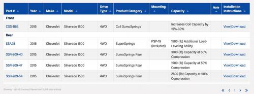

You didn't look hard enough. The Sumo's are offered in 1000, 1500, and 2800 lb varieties for the 1500 series pickups. I just looked it up on their site.
They do not negatively impact the unloaded feel or handling. Unlike a more firm type of thing like Timbrens, they are progressive in their resistance as they are compressed. Unloaded, they actually absorb some of the road jolt that goes on. They do not reach maximum resistance until compressed 50%. On most stock pickups, that would equate to right at where the pickup is level under a full load.
Here is a snapshot of the Sumo's offered for the 1500......
