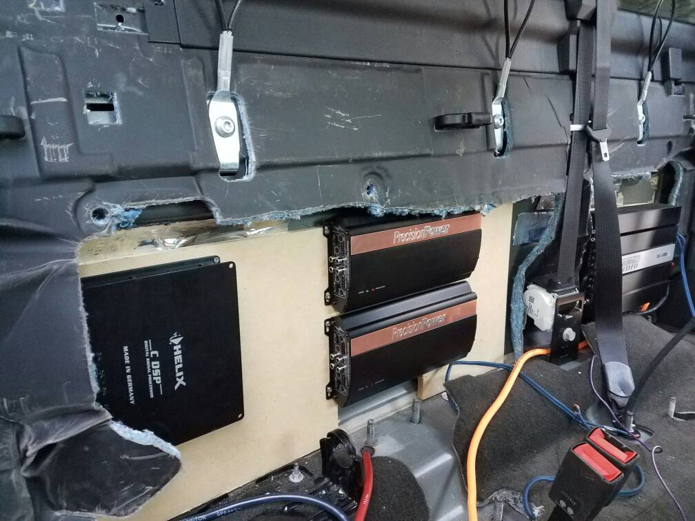

Got all the new wiring in place ready to be connected. Unfortunately, I am now using two amps to power front stage instead of one so I had to place them in a new position. This resulted in my original wire run being too short so had to run new wire all around. Here are some pics of the amps and dsp. I know it's messy but it is a temporary thing as I am still wiring and testing everything to then eventually stick it in some techflex. 8524a6da844912b238614237423d591e.jpg8e7f9add6e881d69436efef83832c4bc.jpg

With your seats back in place, does that area get hot with all the amps running?
Never to a point where it becomes an issue. I did think about putting some corsair silent fans back there but I need to see how these operate.
