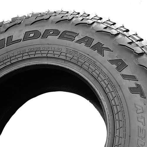

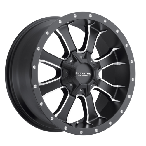

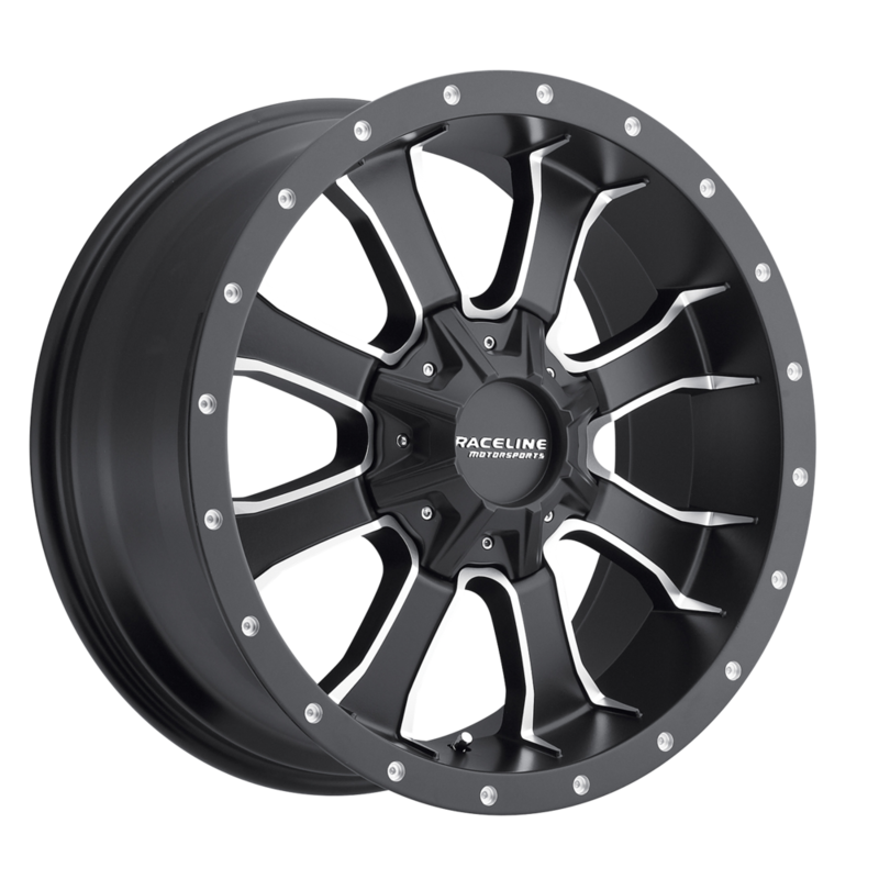

Rough Country 2" front level
275/60-20 Falken WildPeak A/TW3 mounted on Raceline MAMBA HD 20 X9 6-139.70 +18 BKMTMS

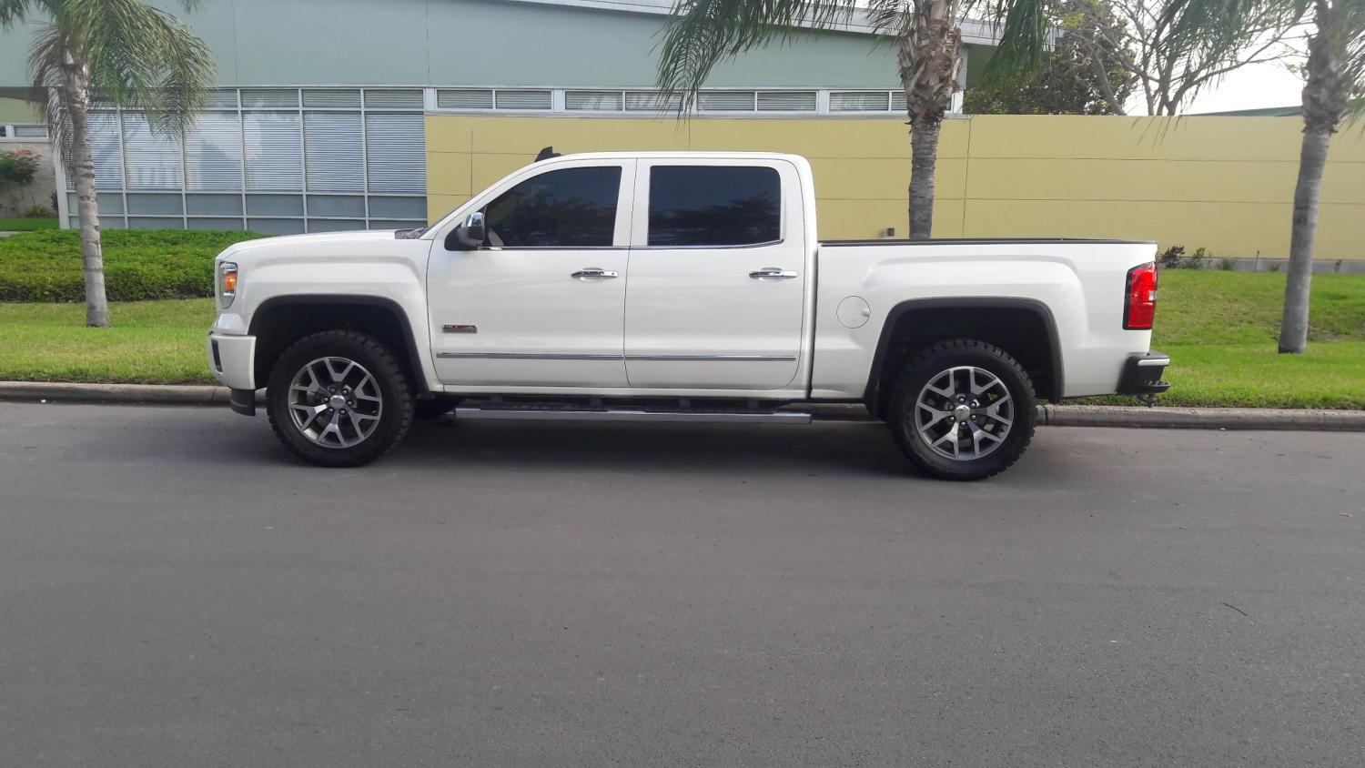

Motofab 1.5" Level. BFG KO2 275/60R20 on Stock AT Wheels
Looks awesome IMO.
Whole warranty cannot be voided.
Dealership must prove that the parts you installed caused the issue for whatever you are trying to have warranted. So if you Level the truck and your ball joints go out, it won't be covered by warranty. But if your third brake light stops working, it will covered as there is no possible way a Level kit could affect the brake light.
Driveability is decent. A little different with a bit more road noise and feel but you get used to it and even after only a week having it on my truck, I don't notice it as much.
Get an alignment done.
No rubbing with my setup.
MPGs has dropped about 1-2MPG but that's a combo of the speedo being off slightly and the greater rolling resistance from the weight and aggressive lug pattern on the tires.
I did get an alignment with the tires, wheels and level kit.
The tires produce almost no extra noise, that I can tell. the truck rides slightly rougher (going from 18" wheels)
and I have a slight rub at full lock at times. I have not noticed and MPG drop. Handling may be very minimally effected for the worse.
the truck sits 2.75 inches higher in the front and .75 higher in the back (tire gain). I did notice that the driver side wheel well sits about .5 inches higher than the passenger side.???

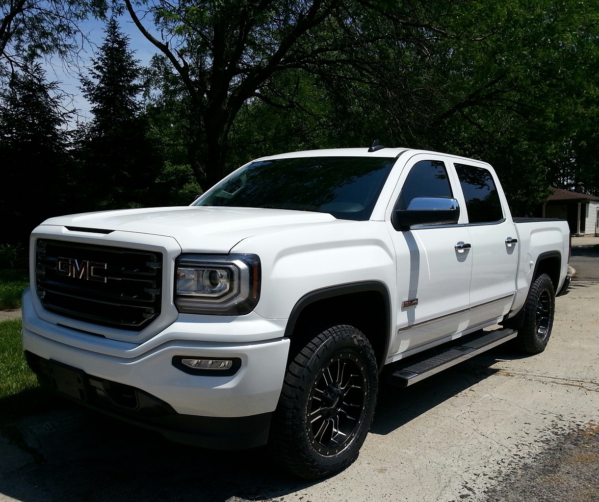

2.5 inch level kit with 33x12.5's Toyo RT on stock All Terrain 20's. Way beefier looking than the stock height and tires. Willing to put up with more wear on suspension pieces and loss of warranty for those parts.
Pros: More ground clearance, truck looks better, and you can fit a bigger tire
Cons: Void warranty suspension components that are related to the lift, not really great for towing/payload (the rake is there for this reason)
