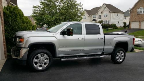

Here the update of my previous 2016 Sierra DC that wouldn't start up on cold days.
GM finally bought it back, and now I have a new 2017 GMC Sierra Crew Cab.
Thanks GM for standing behind your warranty. :happysad::driving::fingersx:
