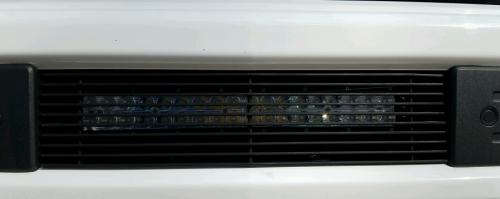

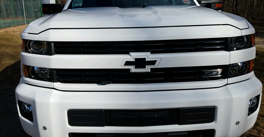

Has anyone added a LED light to the hole in the middle of the bumper? If so what light bar did you go with or what kit did you use. Do you see any ill effects having it block some air flow? I would like to put on there but not block the entire thing.
I'm watching this thread. I would like to put something there and I don't like any of the grilles available.
18 inch behind lower bumper grille insert wired it right to my switch for plow prep beacon from factory. Amazon led bar brightness im amazed by in the great north woods ive had it for 4 months temps below-15 works great
That's how I want to power my LED when I do it. I've never opened up my switch yet, what all did you do? Did you have to remove pillar and everything to run wires? Trying to get as much info before I do this, thanks.
Snake the wiring threw rubber grommet on driver side fire wall chase it up the pillar unbolt overhead console youll see the area with the beacon switch as well as 2 blunt cut wires.. bingo

I just recently put a piece of gutter guard in the space to protect the trans cooler. Works great, looks great. Cost $3 at the local home improvement store. I did get the black painted metal one, no the plastic or vinyl.

They are referring to the transmission cooler hole in the middle of the front bumper. Many people, like myself, are putting grates, guards, light bars, etc, in the hole to help protect the trans cooler.
