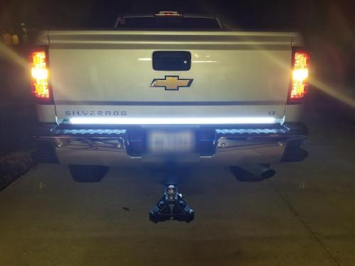

Installed this for backing up and gives camera extra light

I purchased 2 rigid flush mount defuser lights and cut them into my bumper on 15" centers from hitch and wired the hot wire into reverse lights in hitch wiring harness. They have a small 3-way switch mounted into cab for off, on, and on when in reverse where I keep it. AutoAnything.com best $134.00 spent it gives me 180° at 125' of light behind truck.
