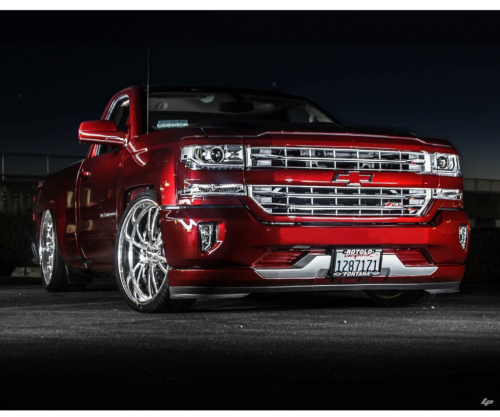

If you just want to get rid of the amber turn signals with out upgrading to the LTZ headlights you can open them up and just clear the amber. They will look something like this.

Would this be just simply removing the amber lens and installing a switchback bulb or something?
The Bulb in LT Lamp is only a turn Signal. The LTZ is a complete LED assembly that has dual function Signal and DRL in a switch back configuration.
I don't know how switchback bulbs function... so can't say what the behavior would be with a switchback bulb only. I would imagine the LTZ lamp has circuitry for the dual function operation.
I would guess so, that is not my truck I just found that truck on Instagram. I believe you won't need switchback bulbs because our turn signals only turn on when we are turning. Our trucks aren't like the GMT900 trucks where the turn signals turn on when the headlights are on. I don't know if it makes sense to you lol.
