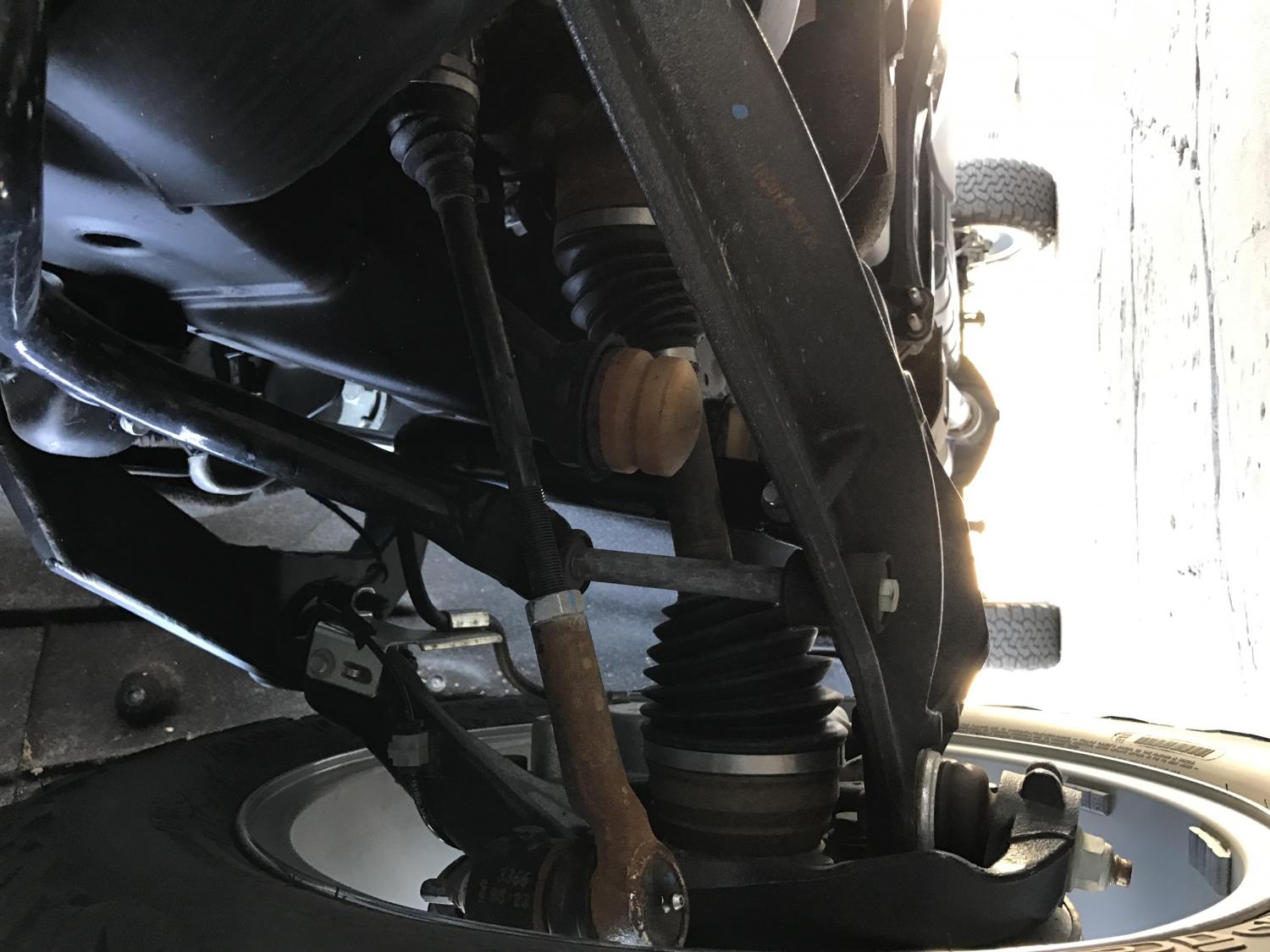

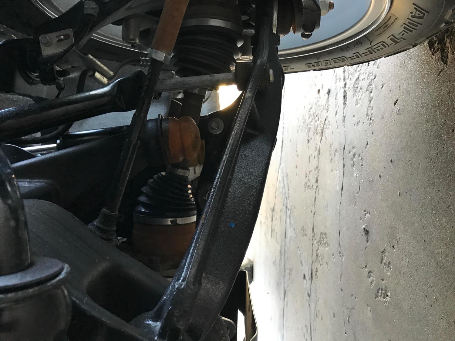

So I bought the Zone 3" adventure series lift kit. I only put the front suspension parts on and it's actually level all the way around. Didn't put the 2" blocks on the back yet. When I spoke with Zone they said the cv angles would be just fine since it came with spacers to drop the differential a little. I took pictures and was hoping people would give their input if the angles are fine how they are right now or if I should lower the torsion bars some more.

C/V axles look ok, I would prefer a little less angle then your pictures show. I would be concerned with your tie rods. Ready lift and a few others make HD tie rods with a small offset to help. Your Zone came with upper control arms? How's your upper ball joints look? I wouldn't worry about the C/V's unless your doing some serious off-roading in 4wd.

Yeah the kit came with upper control arms, shocks, keys and the spacers to drop the differential down a bit. Thanks for the reply. I hate to spend so much money on a truck and have to replace parts too soon. I might adjust the keys some more and drop the front another half inch.
