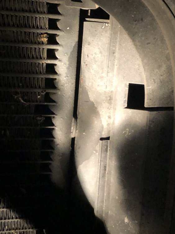

Got two 2015 Chevy Suburban that I use for work in the Los Angeles area. The A/C condenser went out on both of them. Called GM to file a complaint, they told me I am the first one to complain about the A/C condenser, and we can't cover it anyway because car is commercially used. I know it is a lie because when I went to the dealership to get it checked out. The mechanic looked at the top right side" driver side" of the condenser and said here is your problem. So I got really impressed that he knew it right away and i asked him did you see this before? he acted as if he didn't hear me and smiled.
Let me mention that our commercial use is High-End Limo Service, we baby sit our fleet. and we only hire professional drivers. So these 2 cars have never been in an accident or mistreated. So if you are running a search on the web for 2015 Suburban or Tahoe LT A/C condenser leaking problems please be advised that you are not the only one. recall should be set for this problem it must be a manufacture defect.

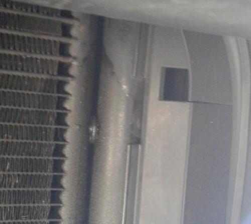

Just feel victim to the CONDENSER known issue on 2015 GMC Sierra with 90K miles on it.. It was literally from one drive to the next this SOB blew out on me.. Anyone have any luck trying to solder the weld as a "bandaide" repair for a couple of weeks? Will be traveling for work so I won't be able to get to replacing the condenser myself for a few months.
