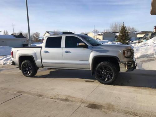

Hello I have a leveing kit now and thinking about going to a 4 inch ready lift. is it worth it I have a 1.5 in tough country leveling kit now but now the dealership is offering a ready lift for 1400 installed and you keep your factory warranty does anyone have any pictures with a 4 inch kit installed and before and after pictures just wondering if its worth the money for that kit thanks in advance this is what it looks like now with the 1.5 rough country level
I'm told the lifts ride better than the level kits.
The readylift is NOT a lift kit, it's a glorified leveling kit that rides like shit. It does not correct bad BJ or TRE angles. If you want a "real" 4" lift get a Zone or BDS.
If you are talking a true 4" lift (not leveling spacers, or stiffer struts), you are talking $1500-2000 just for the part and an equal amount for the install. There are knuckle lifts and bracket lifts, each having pros and cons but the biggest difference is that knuckle lifts make your front track about 3" wider than your rear track which looks ridiculous. To counteract that, you have to run 1.5" spacers on the rear. Knuckle lifts also require a certain amount of negative offset to get the rim away from the hub.
4" isn't going to allow you much more tire than a level -- either way, you are limited at ~33".
Another alternative to get 4" without the track width issue or cutting/welding your frame, is to go Fox or Bilstein struts + Cognito UCAs and a differential drop. Then add a 1.5" body lift.
