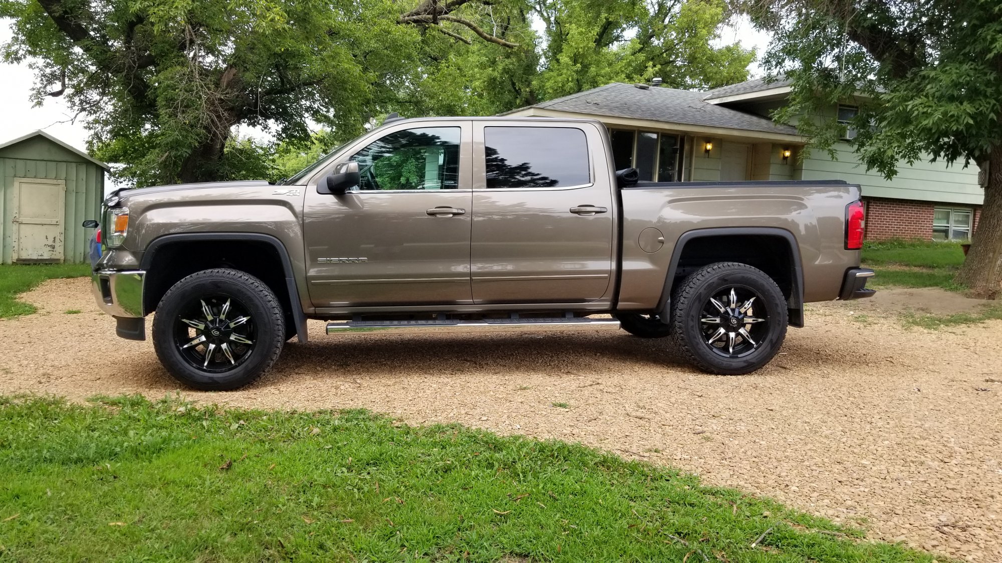

I ran with the new tires for 2 days after putting the level on and I had no rubbing without the level. Also, I did not notice any type of ride quality change with and without the level.
Looks good gupster. Did you leave the stock shocks on in the back after adding the 3.0 blks. ?
Any rub with those tires guppster88? Thats the size I want to go with but maybe down to 18 inch wheels to have a little more meat.

3" front. 2" back. 285/60r20s with Goodyear Wrangler all terrain adventures w/kevlar. They are mounted on 20x9s with a -12 offset. I have the aluminum UCAs. Didn't need to replace them. From the research I've done the stamped steel UCAs might need to be replaced because the ball joints are different somehow and might break or deform.
