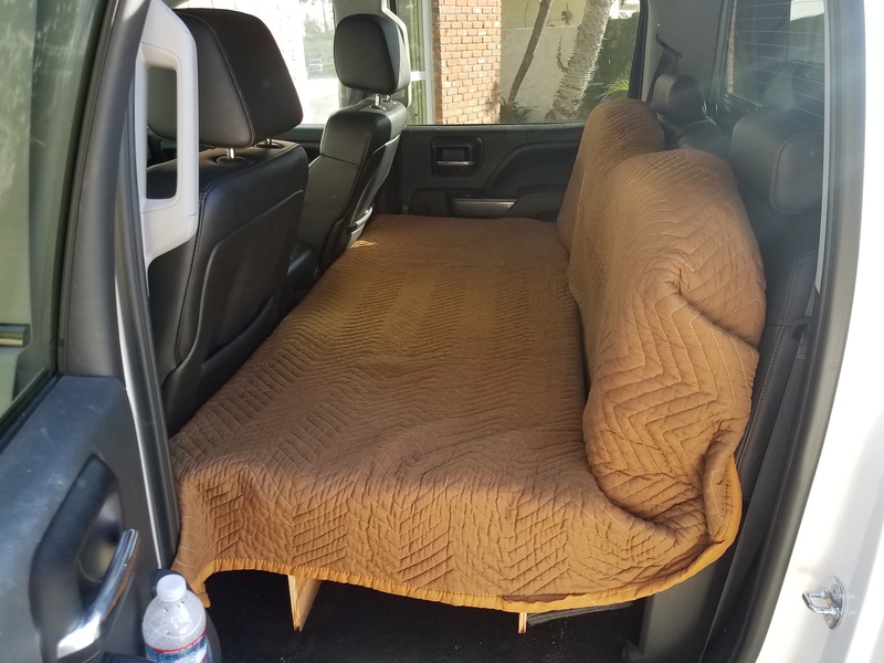

You might just cut a sheet of plywood and stuff some padding under it in the footwell pockets of the floor to level it. Then a foam futon and your bag will make it comfy.

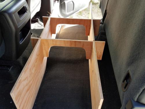

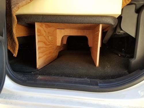

This is what I made for my dogs to travel. 1/2" plywood, 3" foam, moving quilt.. I climbed on it. I could easily sleep on it comfortably. Room for long guns, cases of wine or fishing poles underneath.
I recall seeing this when you first posted it a while back. Looks awesome. You should sell these things. Looks like storing it away is pretty easy too.
