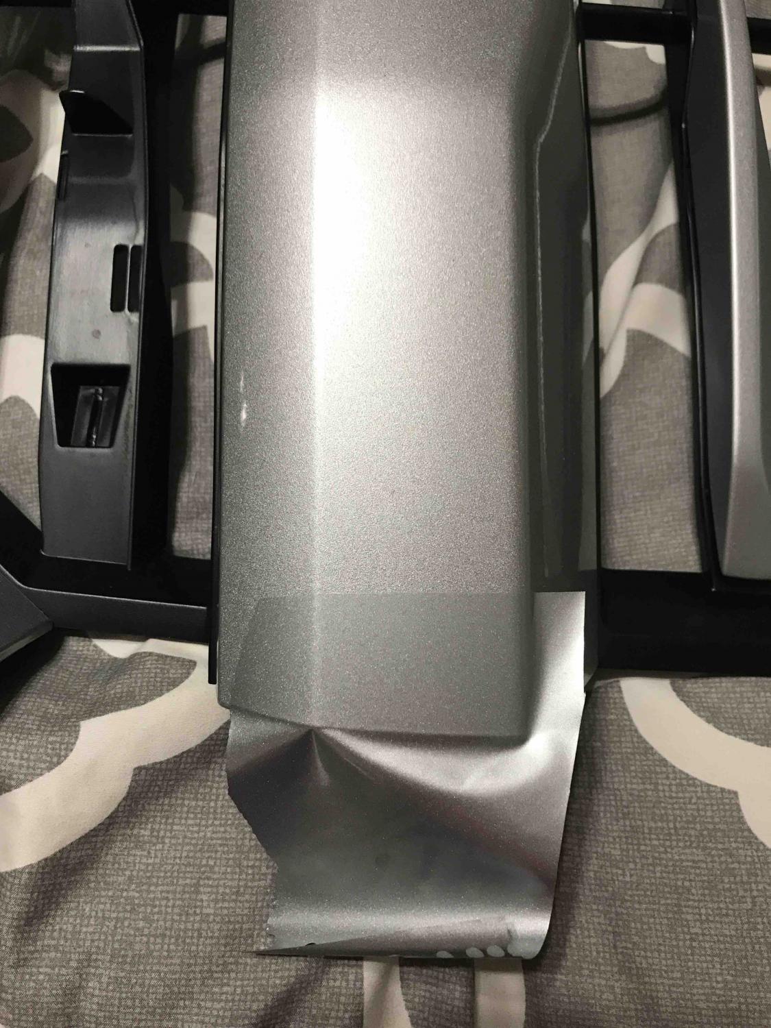

Does anyone know where to find vinyl wrap that matches my paint? I want to do my bumpers and the silver trim inside. I'm just nervous I won't be able to match the color metal flake
You probably won't find an exact match ... especially metal flake. you are at the mercy of the vinyl manufacturers stock colors available. The only way you will match the color is if you go to a shop and have them print / match the vinyl but even then it won't be metal flake, and they will need to have a good color guy to really match it up as close as possible. I would make sure they print and laminate a decent size piece for you to approve if you go that direction because just going by the printed color without the laminate over it could end up bad. Laminates can change the color of the finished product depending on the laminate and the color printed.
Yep, you'll have to paint if you have a Metallic paint. No vinyl will match 100%
My local sign shop had a metallic silver. It's just a tad darker. I don't think you'd notice if it wasn't right next to the paint. I'm sure you can find one that is better, get samples sent to you or take your vehicle to a sign shop that does vinyl signs.
