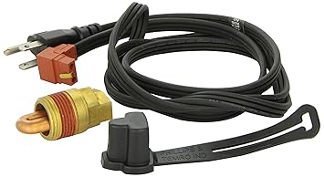

Supreme Pizza Posted September 20, 2017 Posted September 20, 2017 In an attempt to eliminate the suspected piston slap, I have tried everything. Nothing fixes it. The only surefire way I have found to fix the piston slap is: You guessed it - a block heater. The engine is already warm, so there is no 10-15 seconds of slap. Only problem is that if you use too powerful of one, it can vaporize some of the coolant and cause the engine temp sensor to act up (from the "air pocket").
