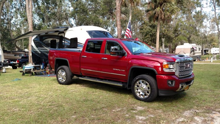

Module didn't fix problem, spent 4hr trying to get the module to fully program.
They made me a really good offer on the truck and traded for an '18 Denali Duramax.
Gave me $5200 less than I paid new, after 20000mi. I am very pleased, and wow does the Diesel pull the camper well
