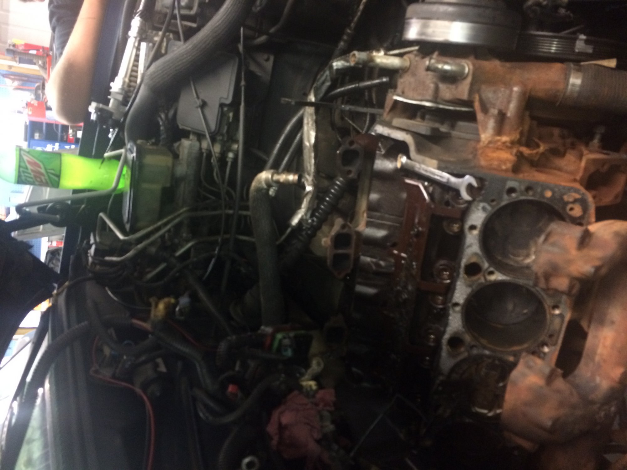

Pic of my engine at the garage with heads off... I was able to get 2 rebuilt heads from a vendor in North Carolina (found him on ebay)... they're working great.
If I'd have cleaned out the catalytic converters last year I'd have probably been fine... an expensive lesson for sure.
