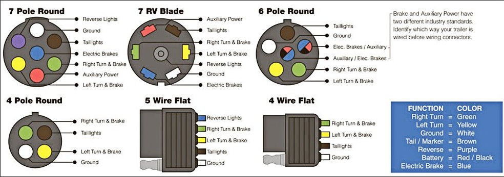

Trying to hard wire a tail light strip into the wires for my trailer plug and cant determine the colour for each wire comjg out of the plug, any help identifying those would be super appreciated
Or just buy a Curt T Trailer harness, then no splicing necessary.  Only for reverse light.
26 minutes ago, 15BlueSilverado said:
This might help...
Super appreciated
