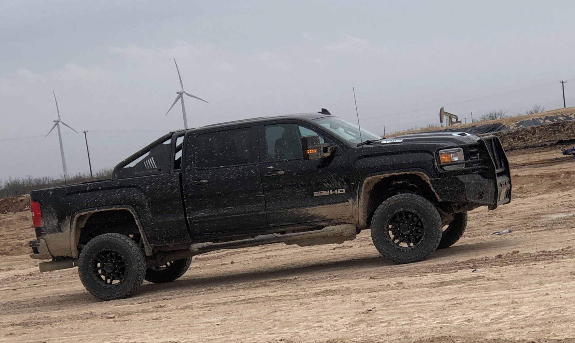

i ended up with 20"x9" with a 4.5 offset. Have Cooper LT35x12.5" Discoverer ST MAXX tires, a little increase in road noises, but stiff sidewalls keep from being dragged into the ruts.  Am very pleased with the results and the ride - adds a nice stance to the truck also.  Only drawback is with the wheels a bit further out - slings mud like a politician.
Sweet. So, that's 0mm offset and 4.5" backspacing, right? Any pictures?
Correct, i know I was going to get that backwards when I posted that, first time venturing too far away from stock. Apologies for the caliche, hasn't stopped raining hasn't stopped raining since the lift was put on.
