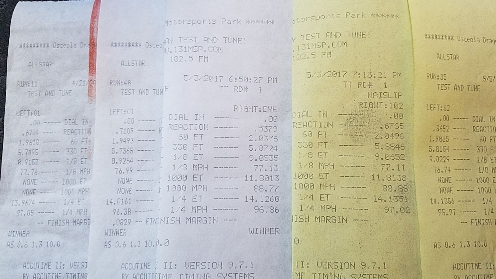

Yeah I have known him for 14 year now. Nice to have a buddy who is a tuner. He is able to remote tune and the best way to get in touch with him is via his Klug Performance Facebook page. We really don't have access to a dyno in this area to show wheel HP gains but he can show crank HP gains via the air flow rates on HP Tuners. For my truck started at the stock 355hp and on 93 with the Airaid MIT, K&N drop in filter and a muffler swap was right around 385-390hp. On e85 same mods truck was showing right around 400-405hp. The pictures below show the the gains at the track. I just have the one 93 time slip and the rest was on e85.

Are you running high 13's with a 5.3L or 6.2L? That is damn good for 5.3L bolt-ons if so. If you are taking your truck to the strip, water meth would not be a bad idea at all if you have a buddy who tunes and can get the kit cheap. See if you can start killing 13.7s 2018 Ecoboosts with a NA 5.3L haha.

2017 Silverado Double Cab Z71 4x4 5.3, 3.42 gears, stock 265/65/R18 wheels, 6 speed, full street weight, 5400lbs with me in it, and only mods are  Airaid MIT, K&N drop in filter, Black Widow 250 muffler swap, and a Klug Performance e85 tune. :)
