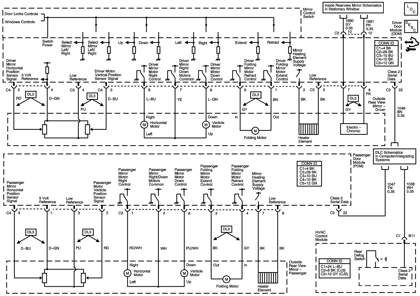

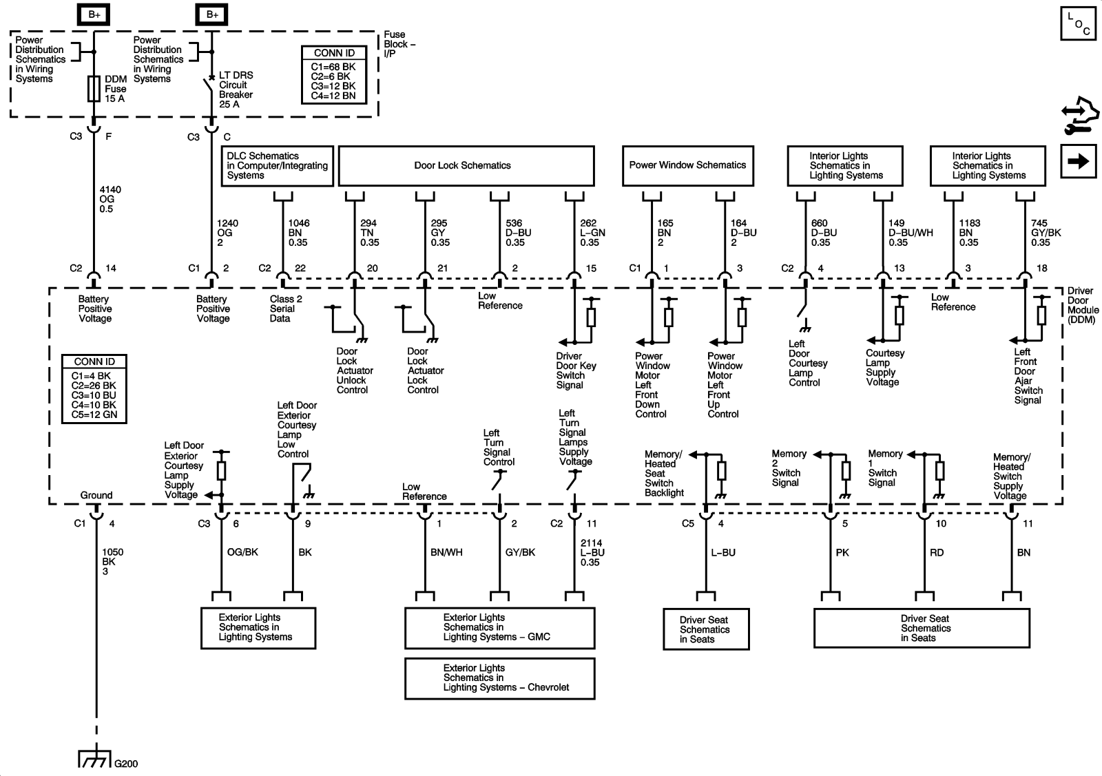

Is it the 2006 Silverado we are talking about? Check the DDM fuse, 15amp in the left side IP Fuse box.
If that doesn't work I could lead you through some schematics if you are a little mechanically inclined.
Another thing is. Where did you get the switch from? This vehicle the DDS is part of the DDM. Which means it has to be programmed. If it is new it may just require some programming from your local dealership.
ALSO could you get the me VIN Number for your vehicle and I can double check what part number and everything you need to get this working properly.
