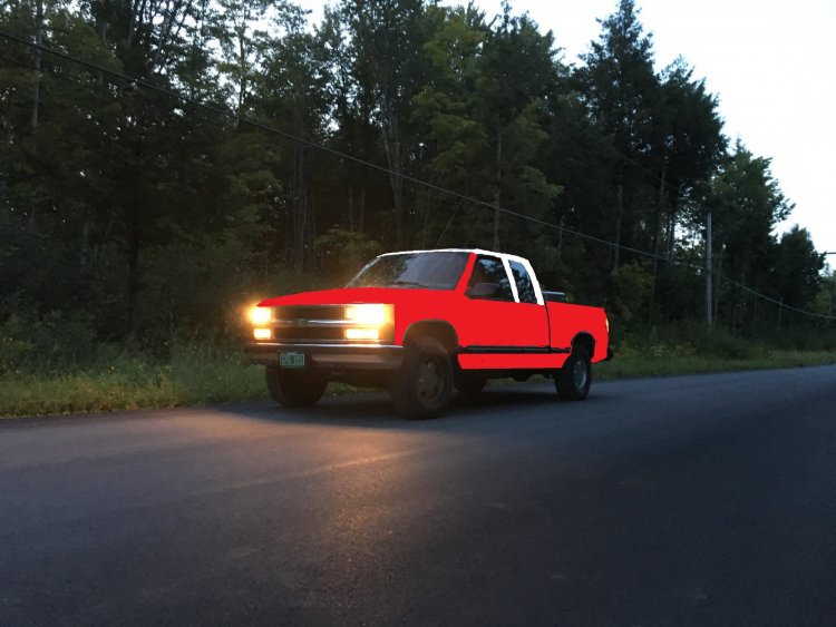

My clear coats peeling and the paint needs some work so I plan on repainting my truck.  I thought about going with the stock green but the paint is expensive.  I tossed around some ideas and decided I might want to paint it like my '82 GMC.  I drew it up very roughly in Microsoft paint (it doesn't look very good)
