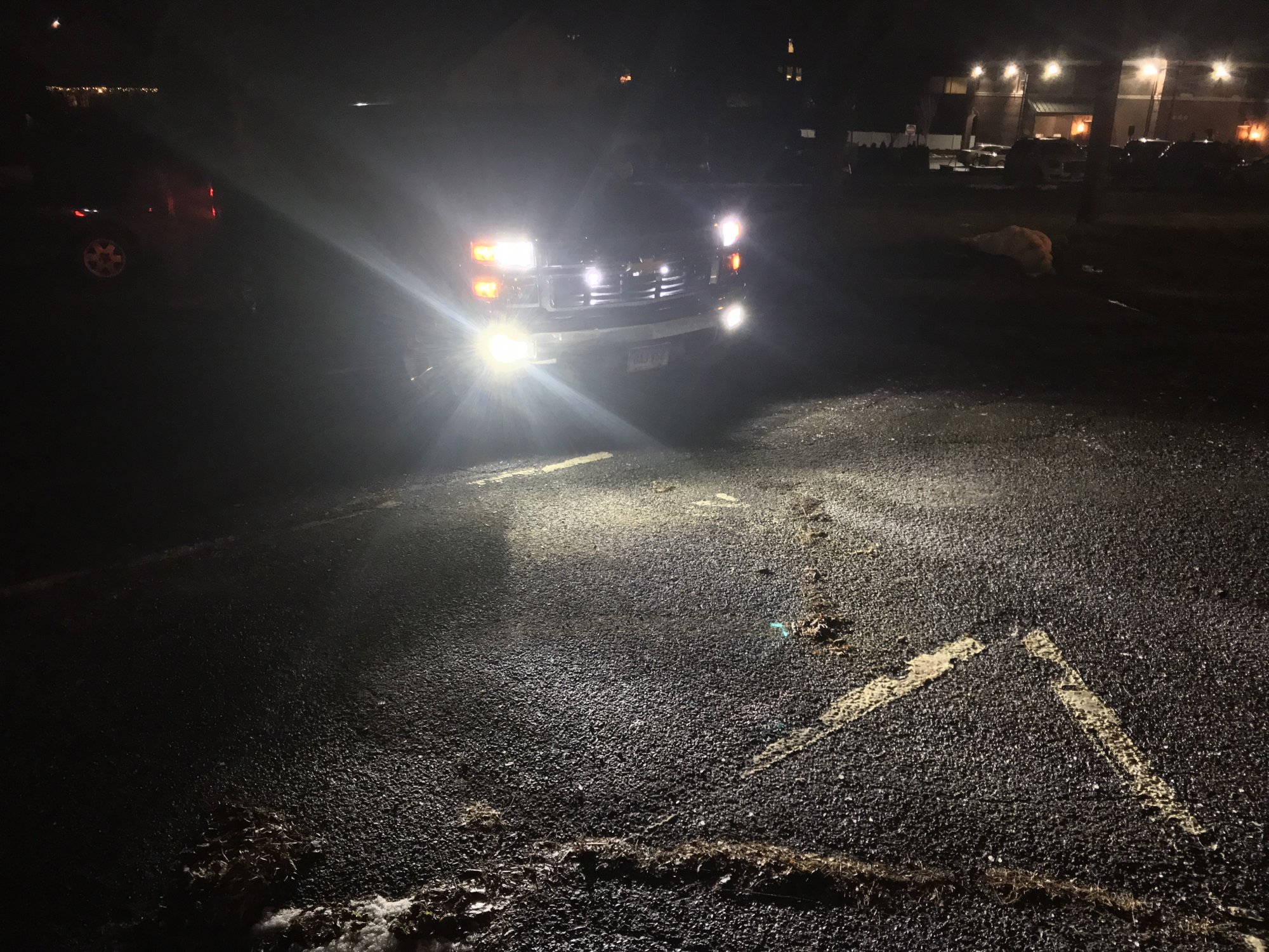

I upgrade my low beams & fog light to DDM Tuning Raptor 35W LED bulbs. Ive been running these for the past year and have not had any issues with them. When the lights first arrived from ddm tuning i was very impressed on the quality of them, in the past ddm lights have been hit or miss especially with their HID Kits.
I do recommend purchasing the led fogs lights they make a significant difference at night and you wont ever need to hit you high beams. Occasionally i will have an idiot Subaru driver flash their lights aggressively but the rest of the time people dont react.
If you have a 2014 or newer Silverado you will need to also purchase a pair of headlight decoders in addition to the LED bulbs. Since Silverado have DLR light, the decoder is needed.
If the leds in the fogs are sufficient to not need high beams. You're probably blinding all the drivers you're going against. You should avoid that considering fogs should be aimed low and wide not high up.
Used them in the fog a couple weeks ago, was better off without them on.
