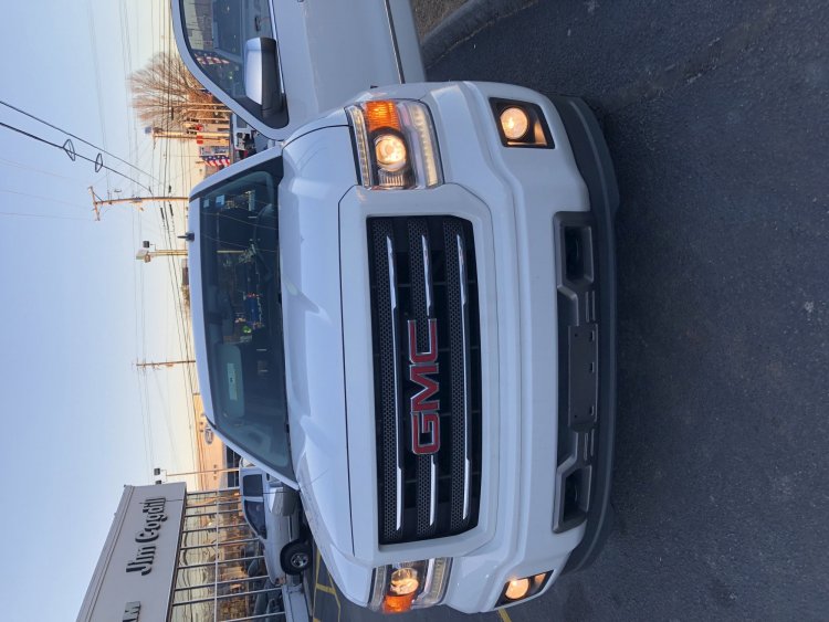

Can someone educate me on daytime running lights on the 14 & 15 Sierra’s? I thought the DRL were white like a 5000k color temperature LED?
this truck seems to have a halogen orangish looking daytime running light, is there a separate bulb that lights up for the DRL?

The DRL is bottom set of LEDs. They illuminate brightly during the day. When the headlights are on, the bottom row dims, and the top row comes on.
If you want to see what they look like, start the truck and put it in Neutral & set the parking brake. It’ll have to be daylight out for them to come on.

In your picture above, you have all the lights on.  The dimmed LED strip is the DRL when the vehicle turns the DRLs on.  Anytime the lamp switch is out of AUTO, it dims.  If in AUTO, and the DRL is on, anytime the turn signal turns on, the DRL on that side momentarily shuts off.
As far as color matching, the DRLs that GM has been using are in the 5000-6000K range it seems.  The 2016+ lamps look almost 6K.  I'd say if you try an LED headlamp in that range it would be fine.

Check your part number on the assemble. GM made the switch early in the 2014 MY to more white DRLs.
I think that’s what’s happened because this just doesn’t look white to me
