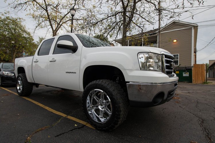

I just saw a member over on Silverado Sierra forums just got the CST kit thru Autoanything for around $1500.00. I bought my CST4" kit from Performance Lifts also.
Great customer service from them, answered any questions quickly. When I did mine I went with the Bilstein adj. struts up front and the Bilstein rear shocks.
If I end up keeping this truck I will be upgrading to the CST coil overs made for the new kit.
Here is a picture of my 2013 GMC with the CST 4" set at 4 1/2" . You should be real happy with the CST kit, they are definitely top quality.
