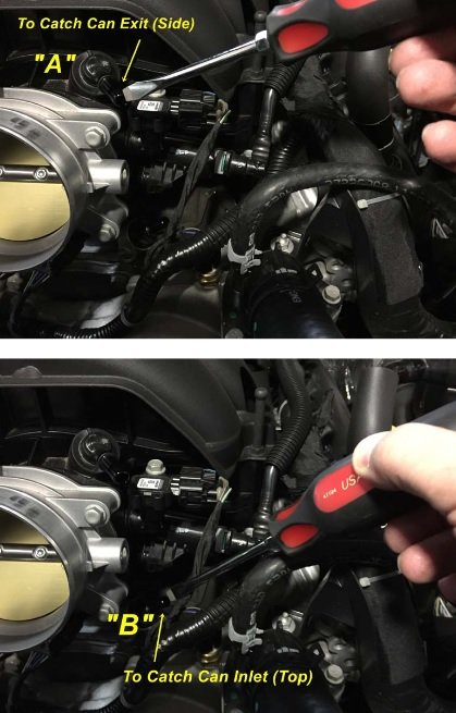

I'm making up my own catch can and will be installing soon. I need some help on which hose goes to the inlet of the can and where the outlet goes. I knew this a few months ago but have since forgotten. If somebody could post a picture of where they go that would be great!

Valve cover is inlet, intake is the outlet...flow is from valve cover to intake.

Thanks Steve, thought that's how it went but wanted to be sure.
