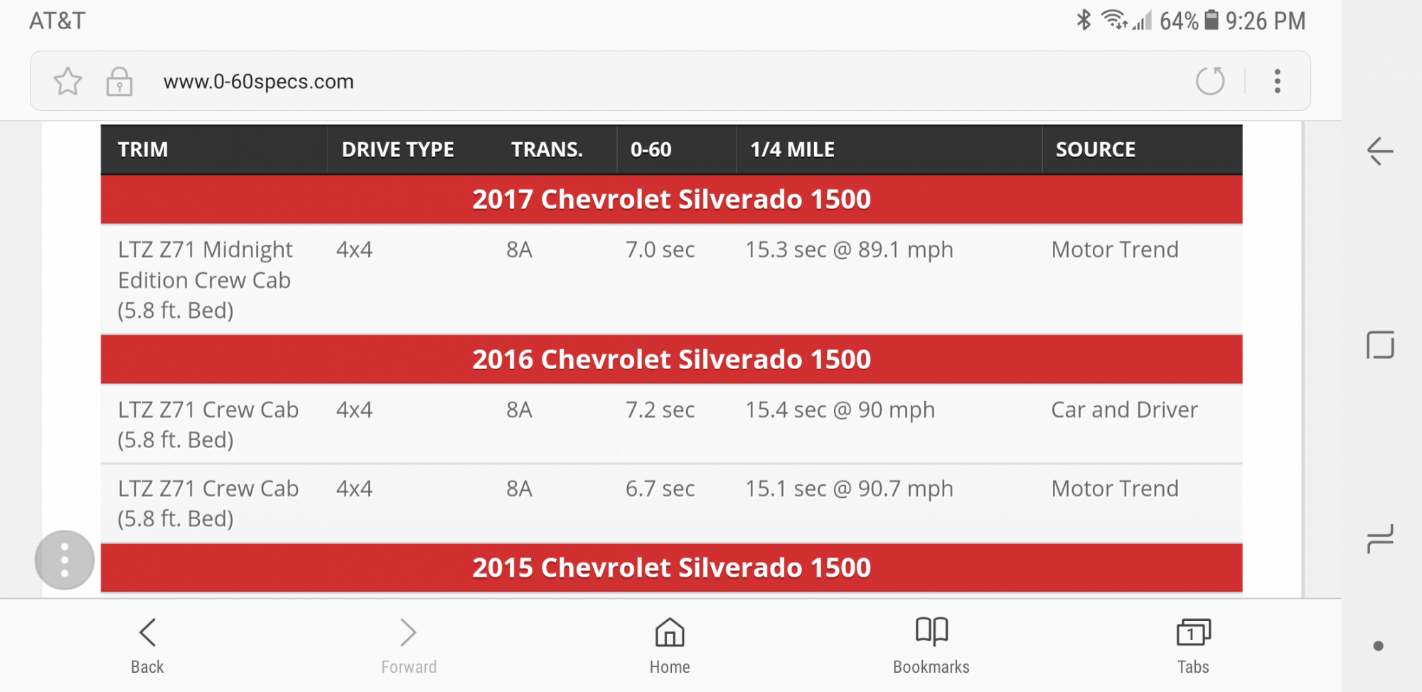

Definitely looks like it ran harder in the first video. I’ve only launched mine in 4 hi and left it there. Is 4 auto safe to launch in? Here’s a video of my stock 6.2 4wd launch.
I've always launched in 4wd but I saw a lot of guys launching in auto 4wd and wanted to try it. Also I heard a flash start with the Circle D converters normally have faster 60ft times vs stalling it up.
