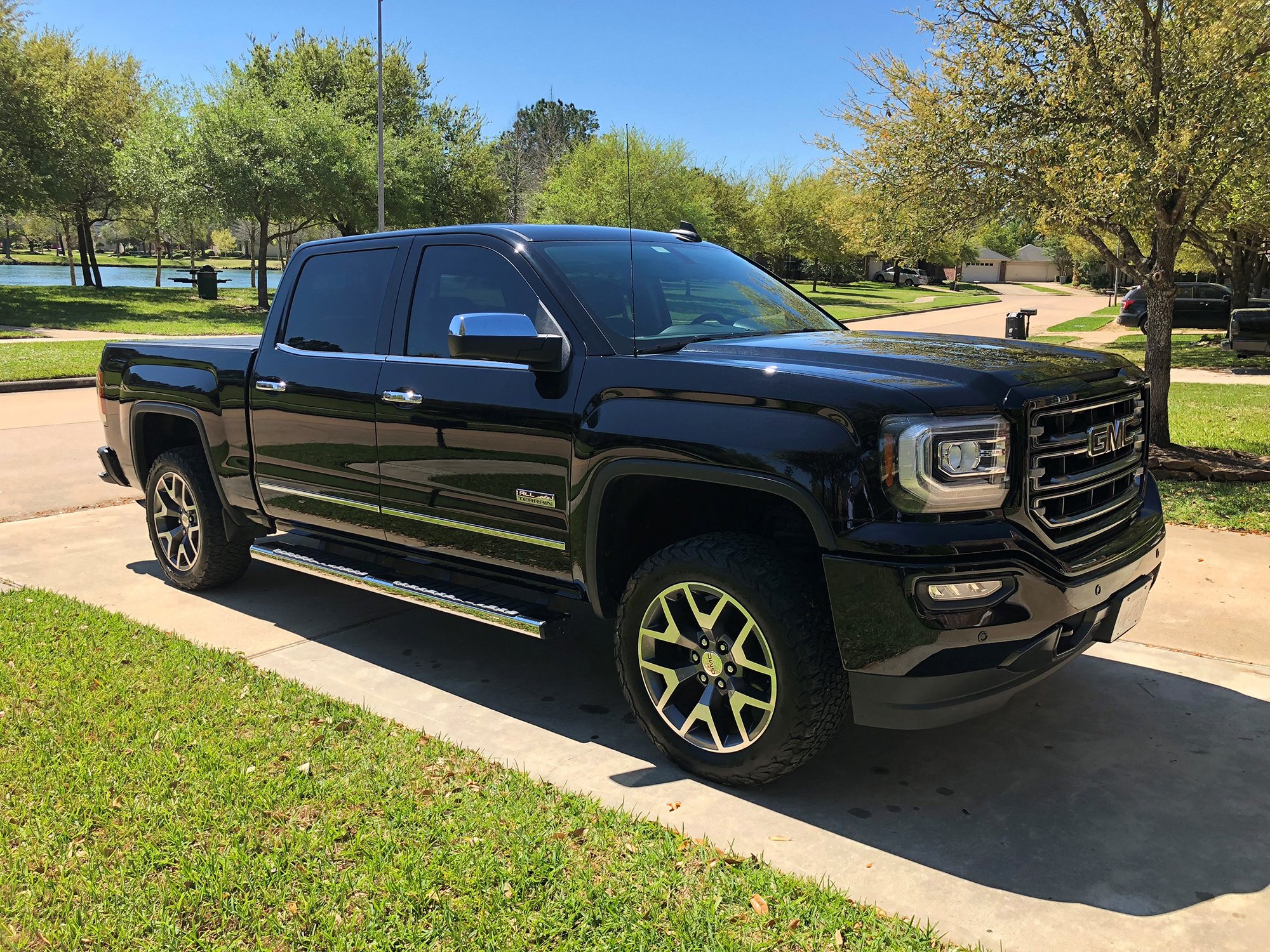

I have 2016 CC All Terrain with 30k miles and started to hear a clicking sound coming from the front left wheel well while in a full turn to the right.
Video of the clicking here.
I was surprised when the dealer told me it was my rim.  Something about multiple layers of the metal in the rim not properly fused together...
New rim, no more clicking.
Hope this helps others diagnose a similar issue.
