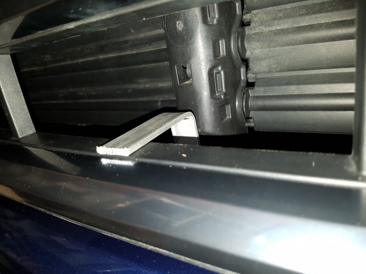

I thought of this for mounting some Baja Designs S2 Pro's, as they are small and light and should put out good light still. That being said, what are your thoughts on if this mount will work/hold up?
The plan is to use 3m double sided tape on the bottom and under the top to attach to the grille for more support. Hopefully the pictures will show what I am thinking about.5ad4dc196e7de_2018-04-1613_10_30.thumb.jpg.6c83507e5287fce530a53625b8495817.jpg

What happens when your truck decides to close the shutters because your cruising at a steady speed on some dark backroad? No more light

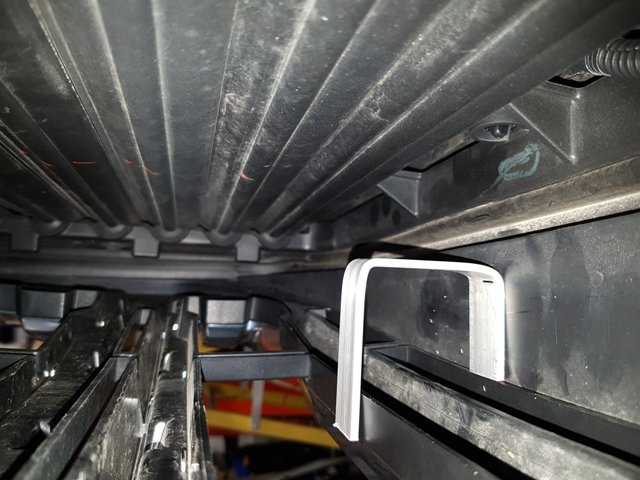

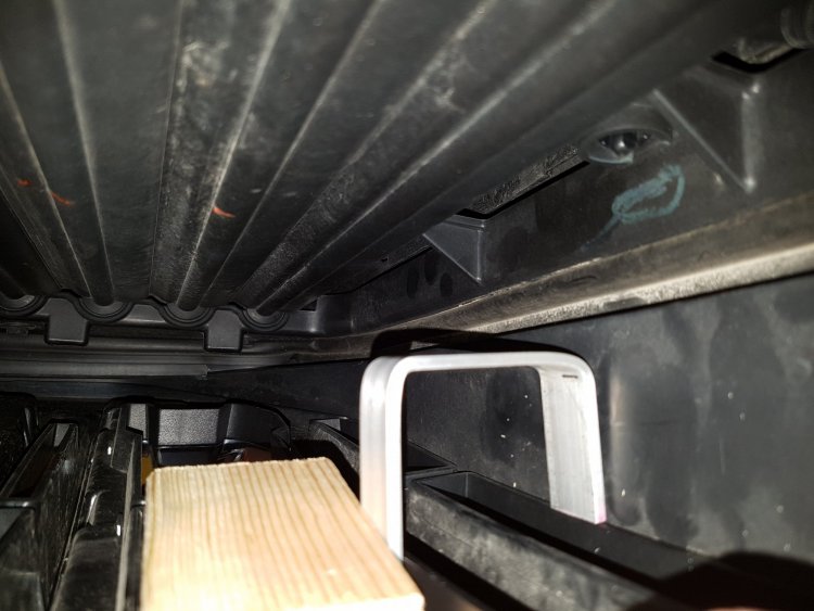

Didn't realize that the picture got rotated, but the bracket is in front of the shutters, the wood block is in the grill opening, and the upright of the bracket is facing the shutters.
This picture should show my idea a bit better.

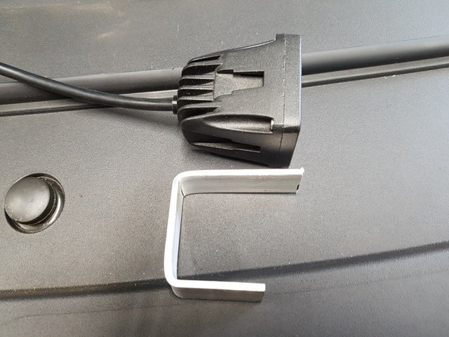

Here are a couple more that show my thought process a bit better. Would like to get some sort of bolt or screw through the bottom.5ad5545851255_2018-04-1613_06_44.jpg.bcf3af5f382254c2ce7e4d08b0764572.jpg5ad55455ad6a5_2018-04-1613_09_29.jpg.15654c9083171ccc74d2b02c2733fd10.jpg
