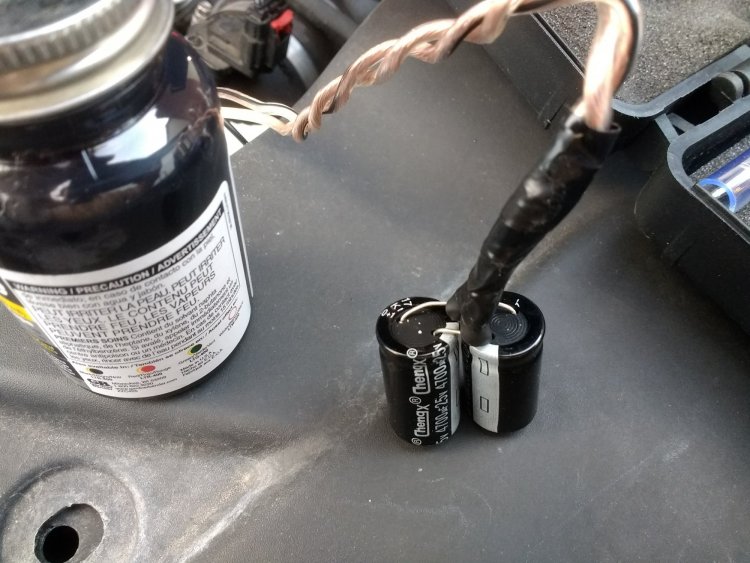

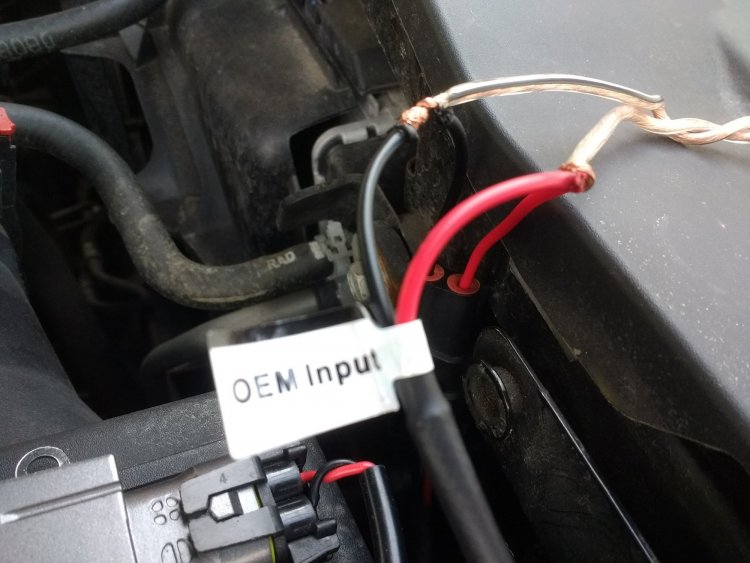

Rambodog Posted May 2, 2018 Posted May 2, 2018 The Spec'd kit still uses a standard HID bulb and fits just fine under the dust cap on the LTZ projector, LTZ replicas by Eagle Eyes, Winjets or the reflector housings for that matter just fine with nothing but a 1" hole for the harness pass thru. I do a 3/4" hole for a tighter fit. The only thing that makes it Spec'd are the caps for anti flicker and an HD harness. I added my own caps to a standard Morimoto kit with HD harness to make my own Spec'd kit. I am confused about why anyone has had an issue putting an HID bulb in any K2XX housing and not have the dust cap fit back on. Maybe LED is what OP is thinking of cause many of the LED bulbs can cause dust cap fitment issues. Or if doing a retro like adding the FXR for example, there might be a fitment issue.
