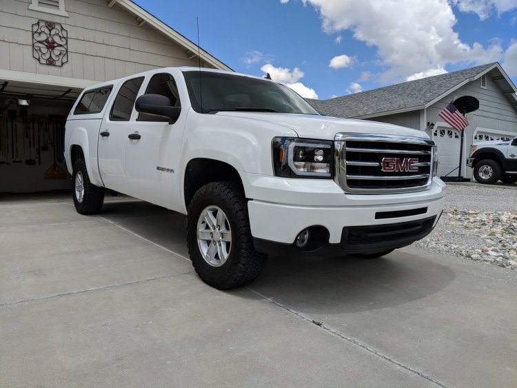

Well I had chrome to start on my 2012 Sierra I sanded it and painted it to match which held up for a total of about 6 months. So I took them off and got them sand blasted and powder coated. Much better coverage this time and I think they will last a lot longer. Love the Denali look it has now.

Thanks been a work in progress lol. For the handles you'll probably have to use something other than Powder Coating since that will only work with metals. My brother just did that to his chrome handles on his Dodge Ram he used Line X Ultra which is a thinner material but turned out pretty good. Has the same finish of like the stock plastics.

Ran $290 for everything. They had to get the old paint off, get through the chrome plating, and then powder coat it.
