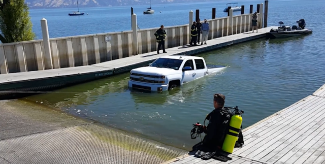

Something to consider in  the 4x2 vs 4x4 category, especially when launching a boat is traction at that location.
This is where a 4x4 would come in handy. If the slope is steep and or wet.
You can get by with a 4x2 if the launch is dry and has plenty of traction.
Having a 4x4 on wet and smoother services is just added insurance.
Then again if you back down too far with a 4x4 prepare for a full truck wash!
