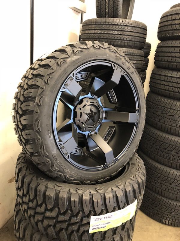

Yea I'd like to a 22x12 with a -44 offset as you mentioned. I'm looking for something similar to this look. I definitely want either a 2 or 4" lift at the most. Sounds like 37's def wont fit with a 4" lift so those are out then.
