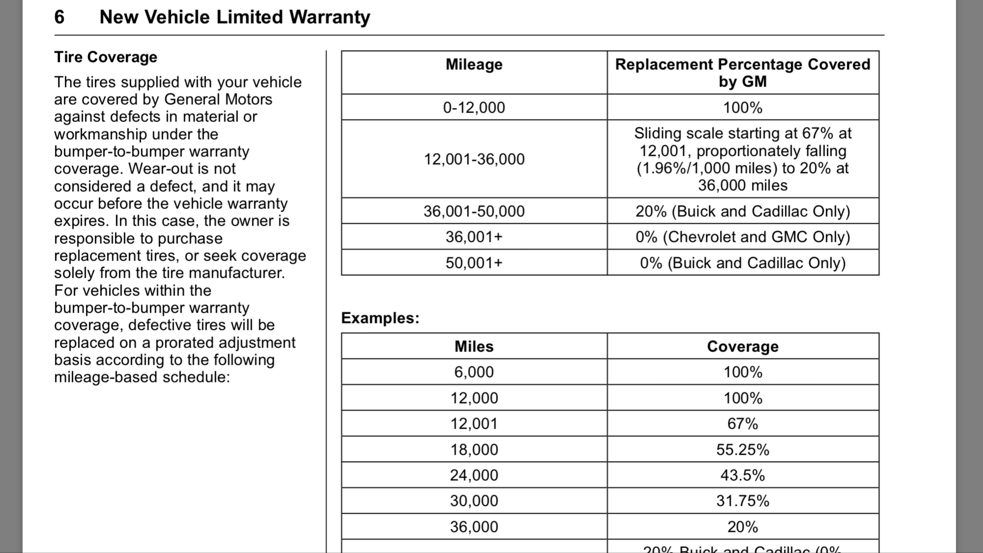

So I thought my GM new car warranty would cover the tire since it is actually called "Base Warranty Coverage(includes tires)" and is 100% transferable, well like everything else, not so simple.
Talked to the dealer and to my "GMC ambassador" and both informed me that the tire is warranted by the manufacturer and pointed me to my warranty booklet that states:
<<<The tire manufacturer's limited warranty program, which can be obtained by calling or visiting the tire manufacturer's website or any authorized dealer, is in lieu of all other remedies or warranties,>>>
Basically means that the manufacturer's warranty is what is covering the tires and since it is not transferable my tires are not warrantied
Seems the GM warranty is 100% transferable, as I was told at the dealership when I purchased the Yukon,  but once something goes wrong......

You are correct by stating that tires are a wear item and normal tire wear is not warrantied by GM or the manufacturer. What is warrantied is defaults in materials or workmanship. A out of round tire is not considered normal wear and is a manufacturing defect.
GM is misleading us to believe they warranty the tire with their 100% transferable "bumper to bumper 3 year warranty(including tires)" when in reality it is the manufacturer that warrants the tire. Why not promote it as it.really is?

I think the dealer and GM told you incorrect information according to the US warranty guide.  The tires should be covered 100% for defects within the first 12,000 miles, then prorated after that.
