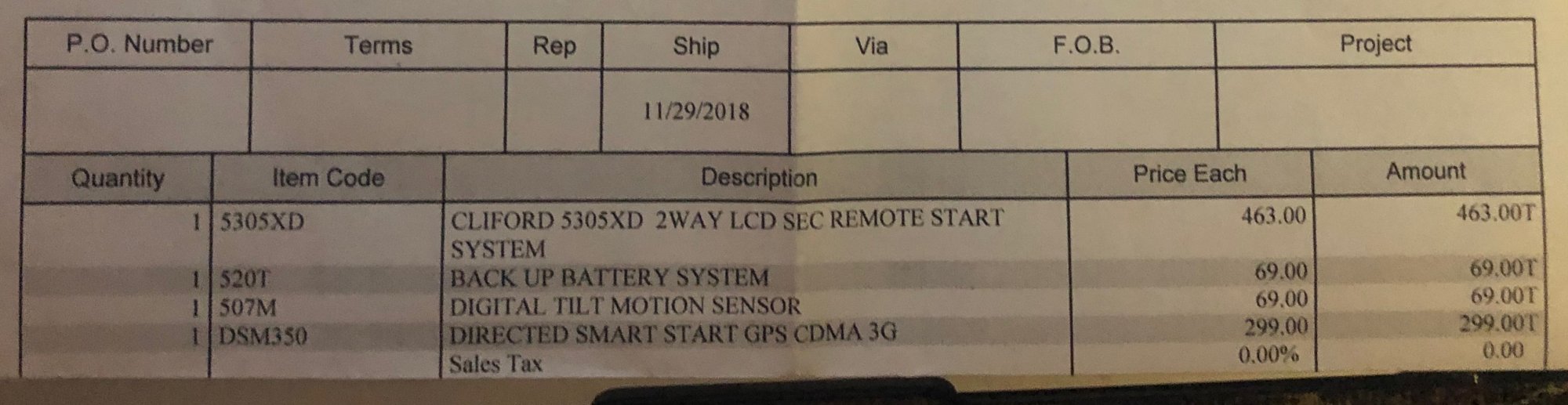

Wow!  Ok... I'm convinced.   Below is the quote the shop gave me.  What are your thoughts here?
