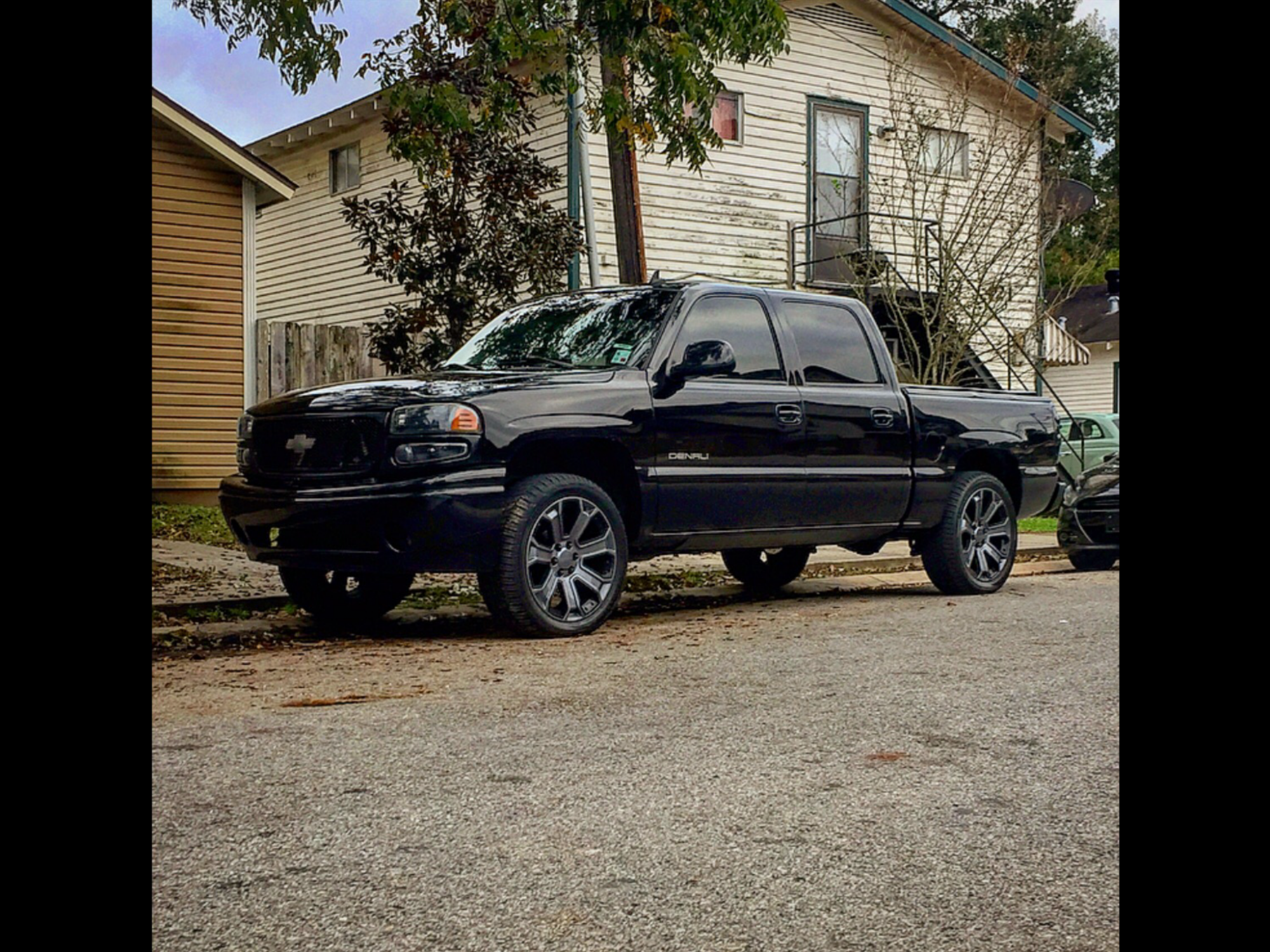

I have a 06 sierra Denali with a lq9 and am on the quest for more power.
Currently I am just rocking a CAI, accell super coils, Taylor cable 10.4mm plug wires, throttle body spacer, non descript exhaust, and a diablosport tune. I have long tubes to put on it, but when I went to install them I immediately noticed that a few of my manifold bolts were already broken and lost motivation (not sure how that happened). I do not want to pull my heads unless I have new ones to put on. At this point in time, I am considering putting in: TSP stage 3 low lift truck cam, ls7 lifters, ls6 valve springs, ls9 head gaskets l92 heads, and ls3 intake, gm performance oil pump, and evientually either a procharger or on3 tt set up with a 2800 stall. I'm a broke college kid so n/a will be the way to go for now, but I'd still like to keep it boost friendly for the future. 600 whp is my dream. Any thoughts/ideas on what route I should go for heads/cam and procharger vs turbo? It is a daily driver and I do pull trailers fairly regularly. I live in south Louisiana so I have 93 octane, but e85 isn't viable for a daily.  Trying to keep it on the cheap. Also planning on doing all the work myself (except tuning). Any and all comments/critiques welcomed; just trying to gain some knowledge and make more power.
