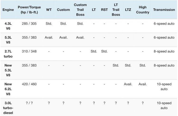

Is the 19 trans the same as previous gen? Mines a 16 and im have the shuttering issue and sick of the circle jerk
Depends on engine since they are still selling the older versions, but there’s a 6, 8 and 10 speed available.
I remember reading somewhere that they're updated. Whether its mechanical or software based... your guess is as good as mine.

Had the same problem in my 2016.
This is what I read before buying my 2019.
My 19 shifts so much smoother than my 16.  No more clunks when down shifting either.
In a line buried deep within a previous announcement uncovered by GM Authority, Chevrolet states that the 8-speed Hydra-Matic in the 2019 Silverado features “enhancements designed to improve shift quality, as well as a new centrifugal pendulum absorber torque converter that reduces vibrations to improve smoothness.”
Read more: http://gmauthority.com/blog/2018/07/gm-8-speed-automatic-enhanced-for-2019-silverado-sierra/#ixzz5awIVrubt
