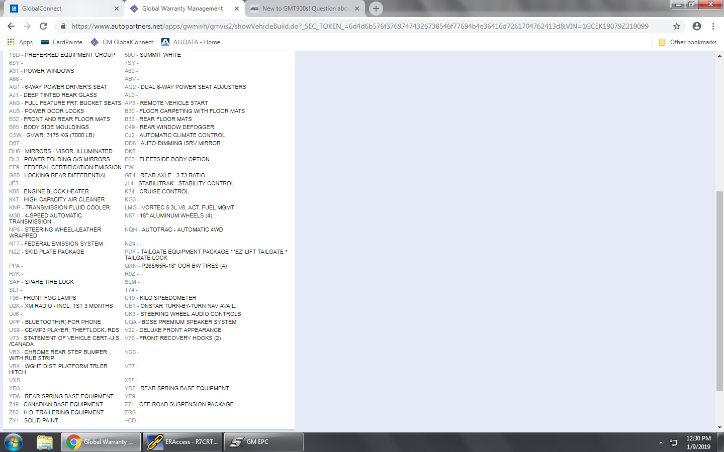

So last week I picked up my first GMT900, a 2009 Silverado extended cab Z71 LTZ with 88k. Today I purused my RPO sheet to see some of the options I have, and my sheet has the Z49 code, which after some research appears to be a Canadian export and emissions code? However, my speedometer is in MPH (with smaller kph), my mileage is in gallons, and I don’t have the block heater that apparently Canadian models are supposed to have.
Additionally, I searched the VIN online to see if my truck was indeed sold in Canada. However, the report (as well as the dealer ad I bought it from) lists my truck as a work truck model, with a 4.8 engine instead of a 5.3, and without the Z71 package... If anyone could shed some light both on what the Z49 package is and why my VIN shows a base model instead of an LTZ that would be appreciated!!

The mileage checks out on both the dealer end and the history report I saw... RPO sheet matches up as well - for example, the Z71 code is listed. I was wondering if the ‘Canadian Export’ RPO code I’m seeing is affecting the VIN?
Not saying I don’t believe y’all, but I’m hard pressed to believe somebody bought a 2009 work truck and swapped the 4.8 to a 5.3, the cloth bench seat to heated leather captains seats, added factory remote start, added the Bose package... you get my drift.
I will see if I can’t get a picture of the RPO sheet tonight, as I’m driving my ‘88 today.
Definitely a Canadian truck. They could have swapped the cluster. When they put the ad up they probably just used base info, not really that big of a big deal.

Interesting, looks like I have the block heater too - never even thought to look in the engine bay for one. Do you happen to know how ‘Canadian base equipment’ differs from an American truck?
Guessing my speedo is altered since MPH is highlighted and KPH is in smaller lettering... wonder if anything else is different.
Canadian and US trucks have the same cluster.
Your speedo has not been altered, nor has your cluster been swapped.  The truck was simply reprogrammed by someone from metric to English.

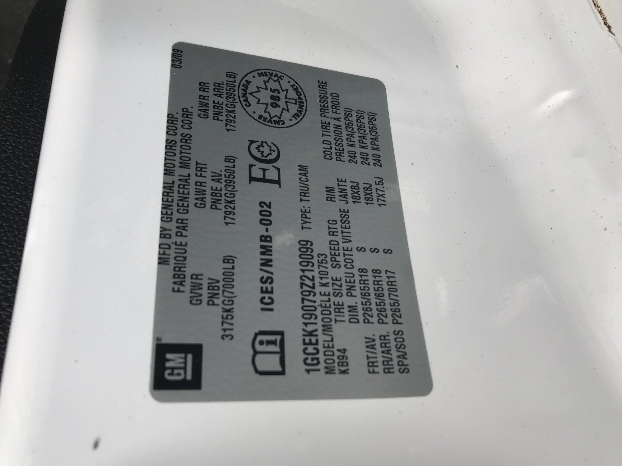

My Denali was a Canadian truck.  I have the French owners manual, and my door weight sticker has a maple leaf on it.  The red wasn't an available color on Denalis in the US in 2009, so that was the tipoff for me.
The truck was clearly reprogrammed, because when I bought it (with 60k miles), the hours meter showed something like 35 hours, and everything is in Us units.  I guess that means they could have reprogrammed the mileage, too, but that gets into criminal fraud territory.
Here's my door sticker:
Here’s my sticker, also has the maple leaf... looks like it’s definitely a Canadian truck. Personally I find that cool, adds to the story for me.
