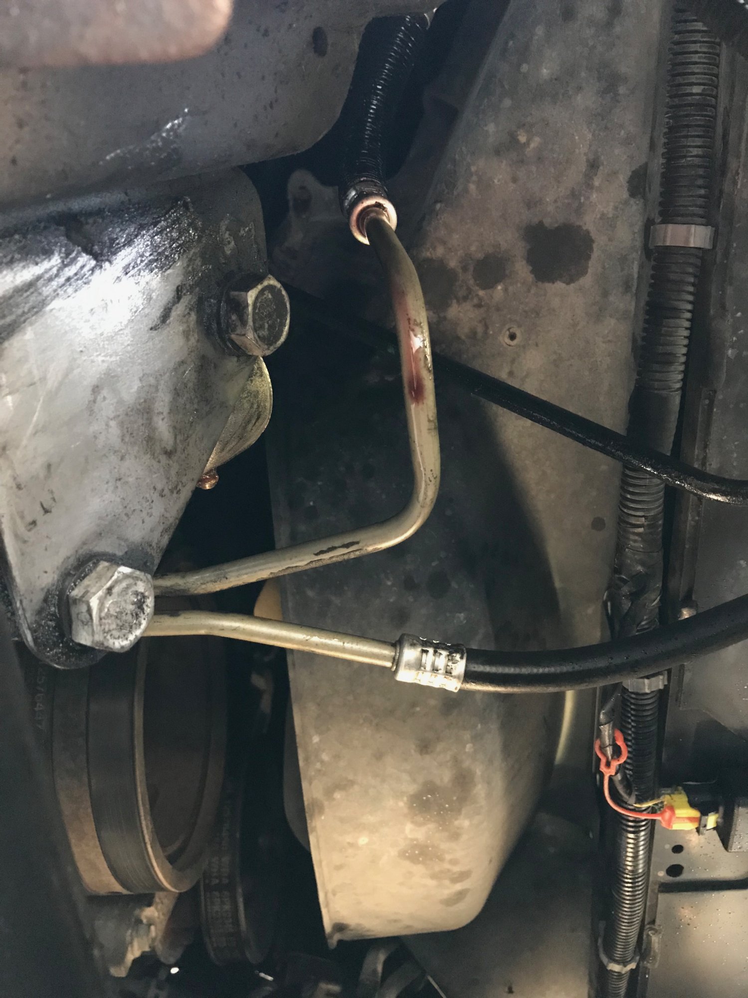

Hey guys, just bought a 2005 2500hd 6.0 from a local dealer. I started to undercoat with fluid film this weekend and noticed a leak coming from one of the lines under the front right corner of the truck. I think its one of the transmission cooler lines. It looks like its leaking from the crimp. Ive attached pictures. What am I looking at here? Any input would be really helpful. Thanks in advance!
Yeah, very common problem with all the lines (oil, transmission fluid, power steering fluid) that use those crimps.
I've replaced all of them.  It's a dirty job, but not particularly hard (worst are installing the transmission lines, as there  a bunch of stuff to route the lines around).  Don't forget to buy the little clips for holding the lines into the transmission & radiator, as you shouldn't re-use them.
