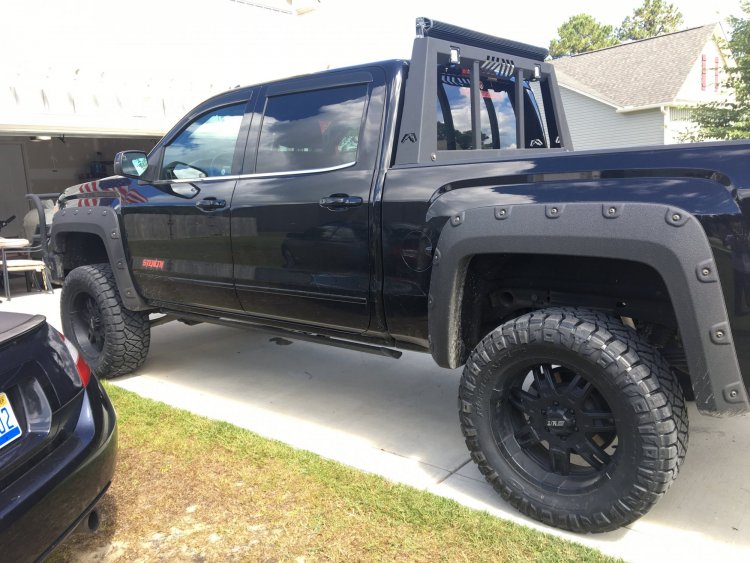

Love mine but remember, these are big heavy e rated tires and you’ll never get the absolute best ride out of an e rated tire. It’ll help with coilovers too or just upgrading your shocks. Here’s mine,
