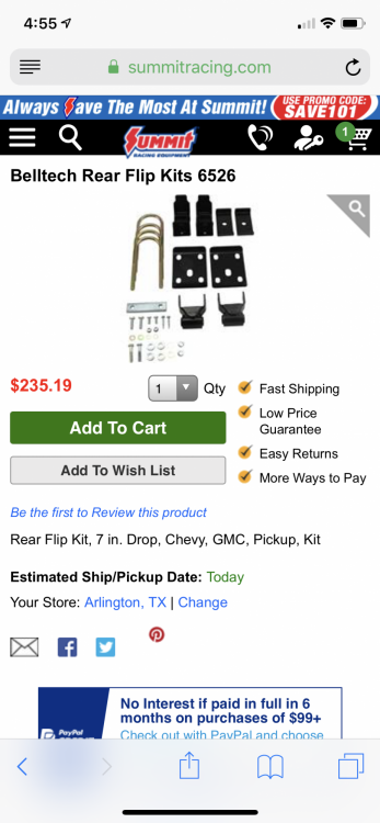

Do I have the wrong flip kit?

I think I’m gunna go to summit then and get a different flip kit

Okay...I’ll ask because I just don’t know and I can’t be the only one lol...what is a flip kit?
2 minutes ago, Shibbby911 said:
Puts the leafs under the axle instead of on top
Thank you!
2 hours ago, Shibbby911 said:
I looked at the Belltech one it’s just as wide
Well i didnt have to do anything to my mcg
The mcg direction's say there is a smaller ear on 1 side of the flip saddle which goes to the rear.  So with mcg you dont have to cut anything.  I didnt
Ya that’s what I wanted was the mcgaughys flip but of course they didn’t have it in stock. And they wouldn’t have it till next month. I’m gunna call around tomorrow and see how fast I can get one. I was thinking about just cutting my flip bracket for now till I get a new one
I didn't buy mine from summit. I think i got all my parts from suspensionsuperstore.com
I ended up just cutting my flip kit to make it work till my mcgaughys flip kit comes in. I should have it in a couple days. Seems like the maxtrac flip moved my rear wheels back some
That happens sometimes.  They all do that. Some more than others. Its so you shouldnt have to cut the driveshaft. Mostly for regular cabs. My mcg flip is centered.  Maybe 1/4" off but i cut thr driveshaft 1 1/8"
Oh ok I didn’t know that
