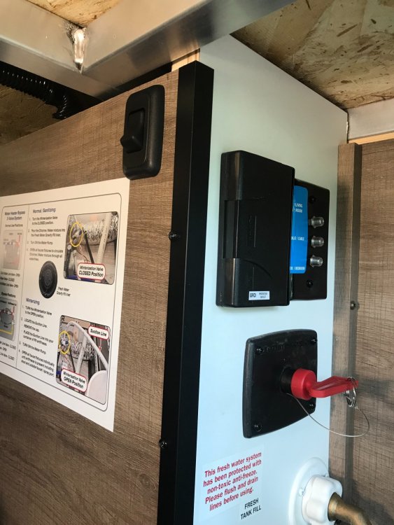

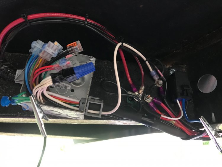

The solution for now, is to hard wire the camera to the battery of the camper, as many of you have suggested you can install a manual switch or a relay tied to the running lights,  to power the camera. It is a pain to have to re-wire it, but it is a solution.

I got the module from Haloview, it's a small box that plugs inline to the power cord for the camera. Using my meter I measured around 10.2 volts at the marker light that I spliced into for power and the module brought it up to 14 volts. The camera powers up after a few seconds of turning on the lights and it worked fine for my first trip (about two hours from home. If anyone else with this problem has a Haloview I definitely recommend contacting them to get a module.

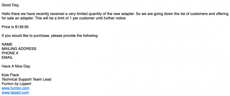

Furrion is now working on an adapter that fits in your 7 way.  It took care of our problem.  They sent us a prototype and we drove over 6,000 miles without a blip!  Contact their customer service department.
