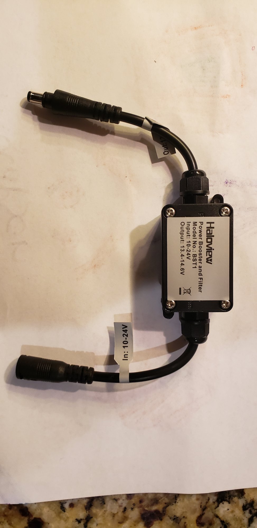

The interesting question, yet to be answered, is when Furrion, Haloview and ASA start mass producing their fixes, will they be free to existing owners or come at a cost?
I called haloview and they said it was in production right now and should be available in a couple weeks.  I hope its free but not holding my breathe.
My guess is that any brand should work to fix the problem on any camera.  My haloview is currently adapted to a Furion prewiring.

Haloview got back to me yesterday.  They are sending me one for 19.99.
I'll be interested to know how well it fits. The one I got from ASA Electronics (Voyager) is much narrower than the Haloview prototype that was posted here earlier. I still had a heck of a time getting it to fit through the small hole and in to the trailer's thin wall cavity. If the Haloview filter is as big as it looks, there's no way it would have fit.  Good luck and keep us posted!

I just wanted to update everyone that our filter is available for those that need it to solve the PWM issue.  There are two versions, p/n PWMBUT and PWMCEC, with the difference being in the connection type.  Our Voyager cameras ship with our CEC connector; however, in some applications this has been removed and have only the +12V (Red) & Ground (Black) wire connected to power source.  For these, the blunt-cut version is used.  For those with our CEC connector, the Voyager CEC version is needed.
I appreciate the feedback we’ve received from J-Stroke, Jack D and geddy76 during their testing.
