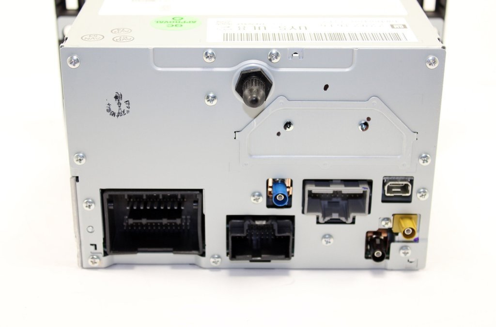

The back of your radio should look like this.
In the box of the radio I just listed it comes with the wiring harness to go from VDR to PGPS. You can send amazon a message on that just to make sure. But I am 99% sure of this. I actually believe I have a few of the harness at the dealership still in the box from the vehicles that didn't come with it. I will double check.
Oh yes, that's what the back of mine looks like.  What does the back of the HU you mention look like. I couldn't find a photo of the back.  It looked like it wouldn't fit because it says 8" deep, which I think is too deep.
