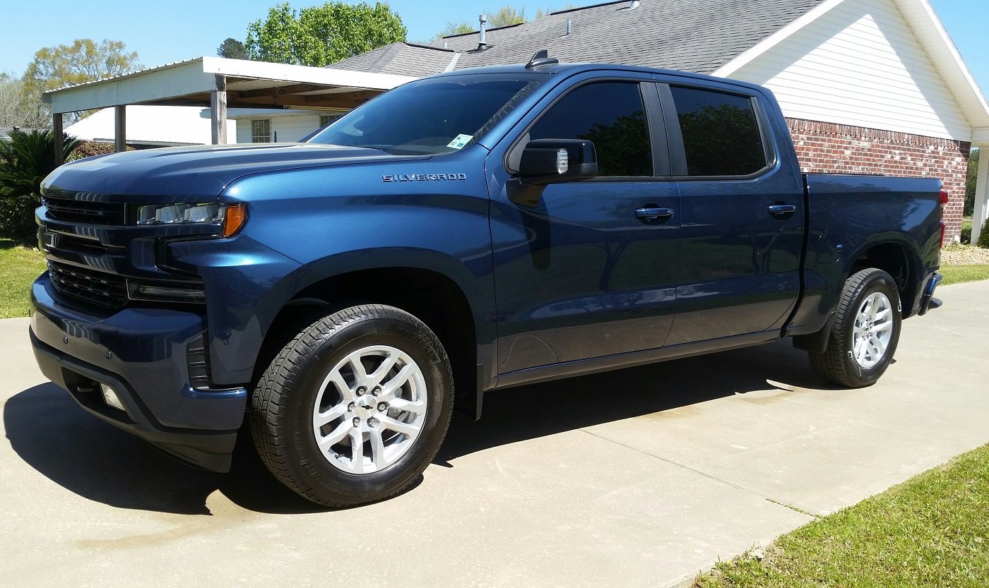

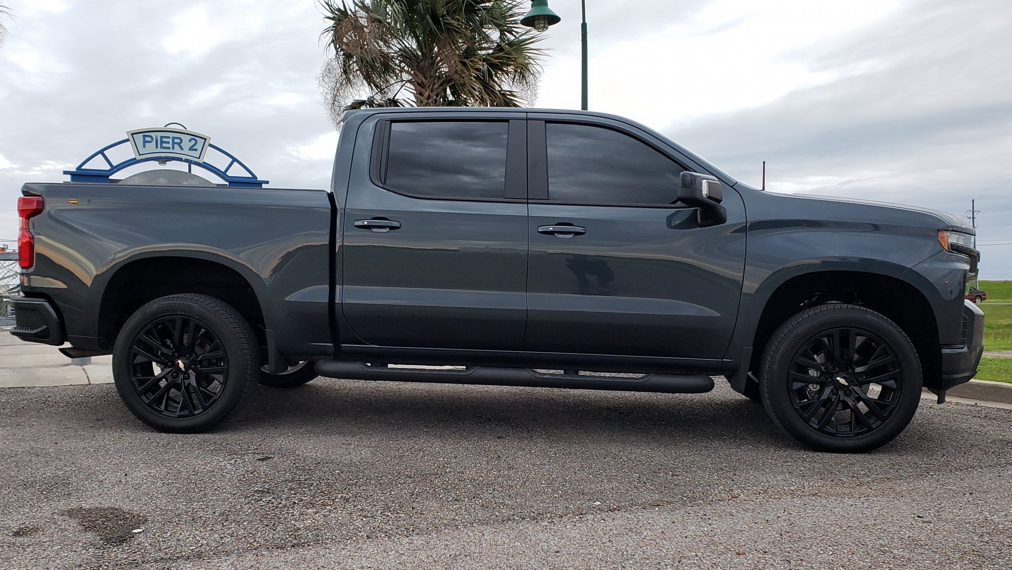

I lowered the rear using 2" drop shackles.  Didn't want to lift the front to level with the rear as I wanted to close the fender well gaps and not increase the gaps.  Truck sits level now.  These are 18" wheels.  I'm fixing to get 22" tires/wheels (street tires) which will close the gap a little more as the tire o.d. will be 33" instead of the 18's which are 31.5"
