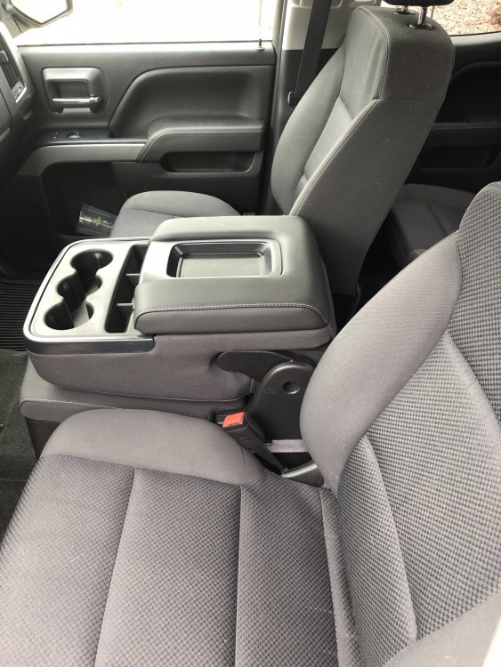

The middle is the only difference, you may have a subwoofer that may need to be relocated.  I have the middle seat, the best part is being able to pass thru and the middle seat bottom is a big lockable storage box.  That and the top box makes it really nice.  In the top box are 2 USB ports and a 12v plug so there is wiring there too.  I'm sure it can be done but it may cost a lot.

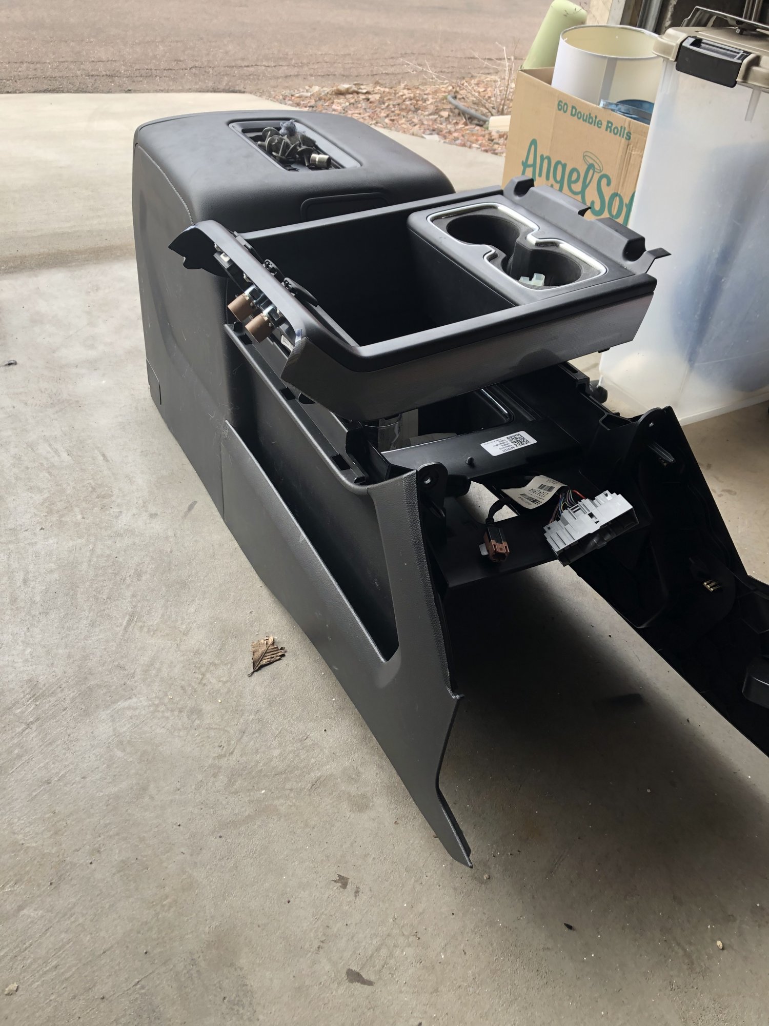

I’m currently in the process of this exact swap, so far it’s been a direct bolt in. The console and jump seat use the same mounting location, there is a dash piece you will be missing and some trim can order from gm that fills in where the console was, it was about 100 shipped, that includes a 110v plug and cigarette type plugin if you already have it. Still working on the wiring, but I was planning on removing the connector on the console and extending the wires to run under the carpet to the jump seat, I will have one extra dual usb that was on my console I’m planning on relocating to the glovebox

I found a Trim shop in Bozeman, MT that was able to swap my console out for a factory bench seat in my 2020 Denali 2500. He documented the process so that it’s easier the next time around. Let me know if you want his contact info. He’s good stuff.

The trim guy said he could replace that portion of the project but I decided to not do that.  The GM rubber floor mat for bench seats covers that area completely.
