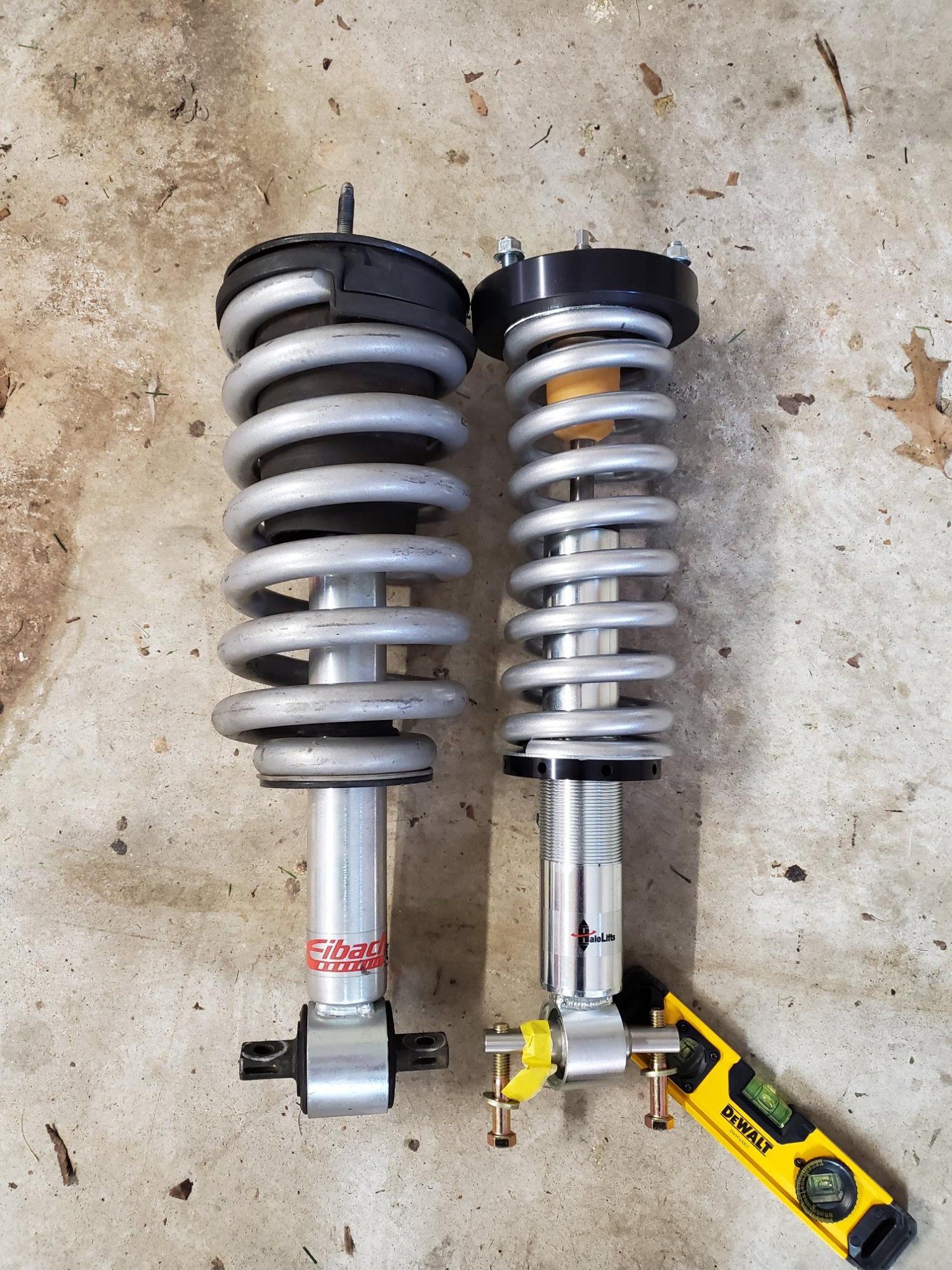

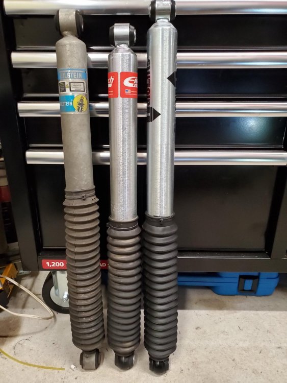

I have a set with about a thousand miles on them already assembled I'd sell the set for $450 + shipping.  You'd have to pay the shipping and it's a 70LB box from Zip 30102.  It would probably end up close to the order price and less than what it would cost to have them broken down and reassembled.  The Eibach is on the left, and in the middle.
Awesome I will definitely consider this. At this moment I’m just seeing what else is out there because if they are having this hard a time getting my initial order to me I don’t want to know what it’s going to be like if I have an issue down the road.
How do you like that halo lift? What’s your max ride height?
I like the Halo Lift.  I'm not going to say it's like riding on cloud but it's definitely improved.  I'm sitting at 3" overall with the coilover set at 2", and two shims under that they provide to give it one more inch.  Plus I have a Zone 1.5" Body Lift.  I will say the ride with the Eibach kit was very stiff when I first installed it and toward the end it started becoming softer.  Of course I'd already ordered my Halo Lift so at that point I was committed to it.  The Eibach spring rate is 828# which is 10% higher than stock which puts the stock spring at around 745#.  The Halo Lift is an Eibach spring also but the spring rate is only 700#.  I'm not a suspension expert but I think  when you start cranking down a coilover, you effectively change the spring rate or stored energy.
